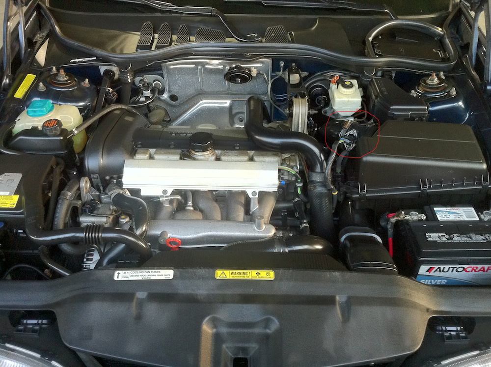

The MAF is indeed right after the airbox. They do vary depending on whether your car is a turbo or a non turbo.
What is the part that you bought, and your year/model?

I circled the MAF Sensor in the picture below...

Thank you. Looks different than mine. Still, I am confident that I got the wrong one. Must be for a turbo or a different year. Should have checked the part number before I bought it.
