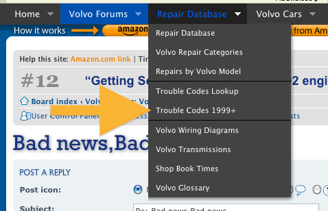

Hey, I've seen that list somewhere... now where was it?glenwyatt wrote:This site may help you....
http://www.actron.com/code_lookup.php
Oh yea...
