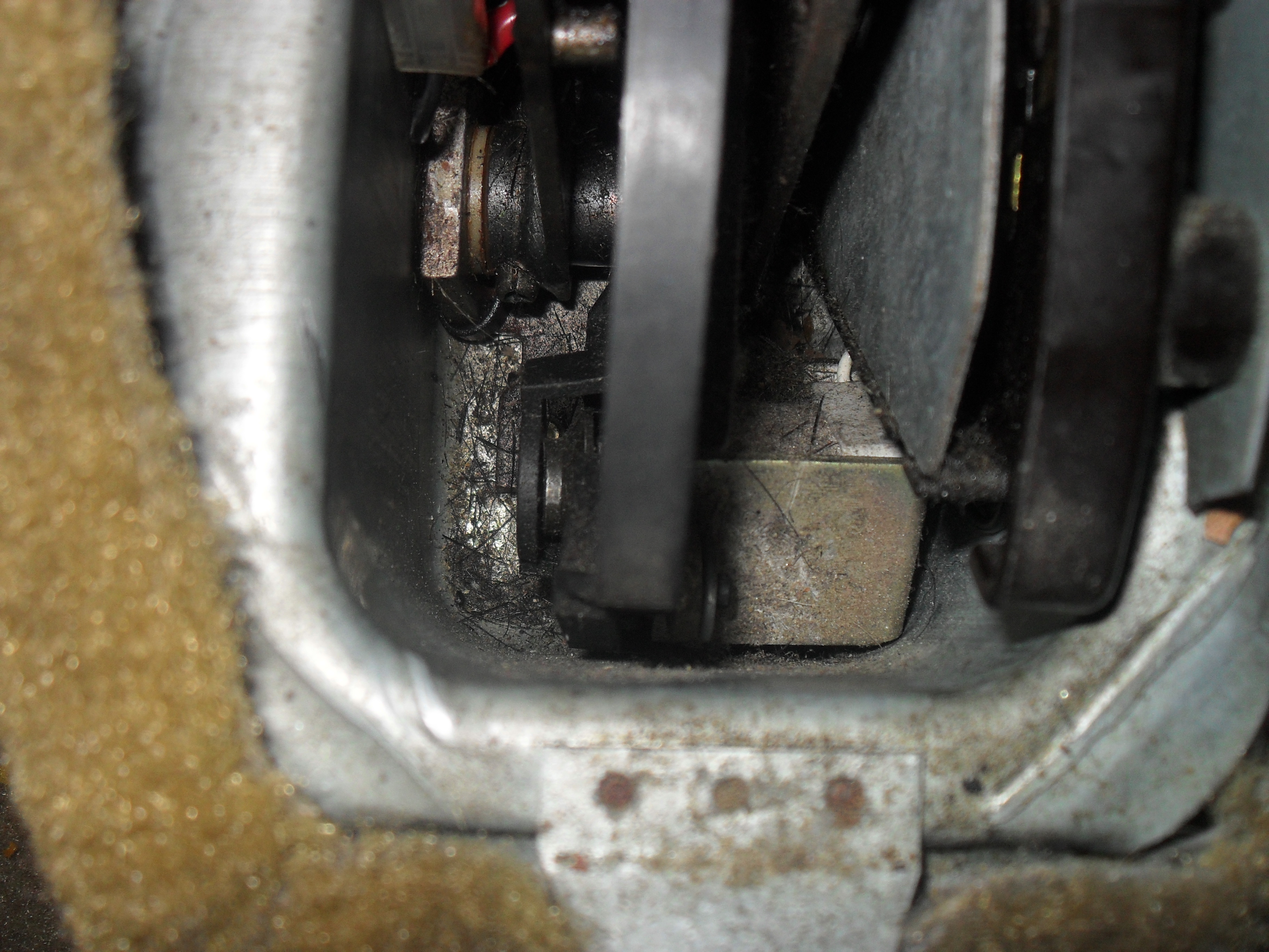

Hello,
I am having a similar problem. The battery is charged, the ignition switch replaced, the starter tested (pass), ignition coil swapped out from a running 240. I removed the shifter cover, something doesn't seem right...square shaped part at back of shifter cavity, it appears as though its broken but I don't have enough experience with these cars yet.
When the key is turned to crank the engine, all the lights come on inside as normal but the engine will not turn over. I left the key on and shifted the gear to "Reverse", reverse lights not illuminated. Shifted through all of the gears, will not turnover.
I am not sure what else to check! My 1990 240 has a 25 amp blade fuse on the left front fender, but the my 1993 does not. My manual mentioned something about that so I wanted to throw that bit of info out there.
Any help would be greatly appreciated.
Thanks,

If the neutral safety switch is damaged or out of alignment the engine may not start or it may start in gear which is not recommended.
The attached shows the location of the neutral safety switch, sometimes called the inhibitor switch. It is headed for the 1989 but is the same for the '93 model. If this is the part that is broken you will need to replace it. If not the broken part it would help if you post a photo of the broken part on your car.

Bill,
Thank you for the info. I will take a picture of the part, thunderstorms have just moved in so it will be a few minutes. The inhibitor switch pictured on the file you attached is not the broken part...or at least its not the actual broken part.
Chris
