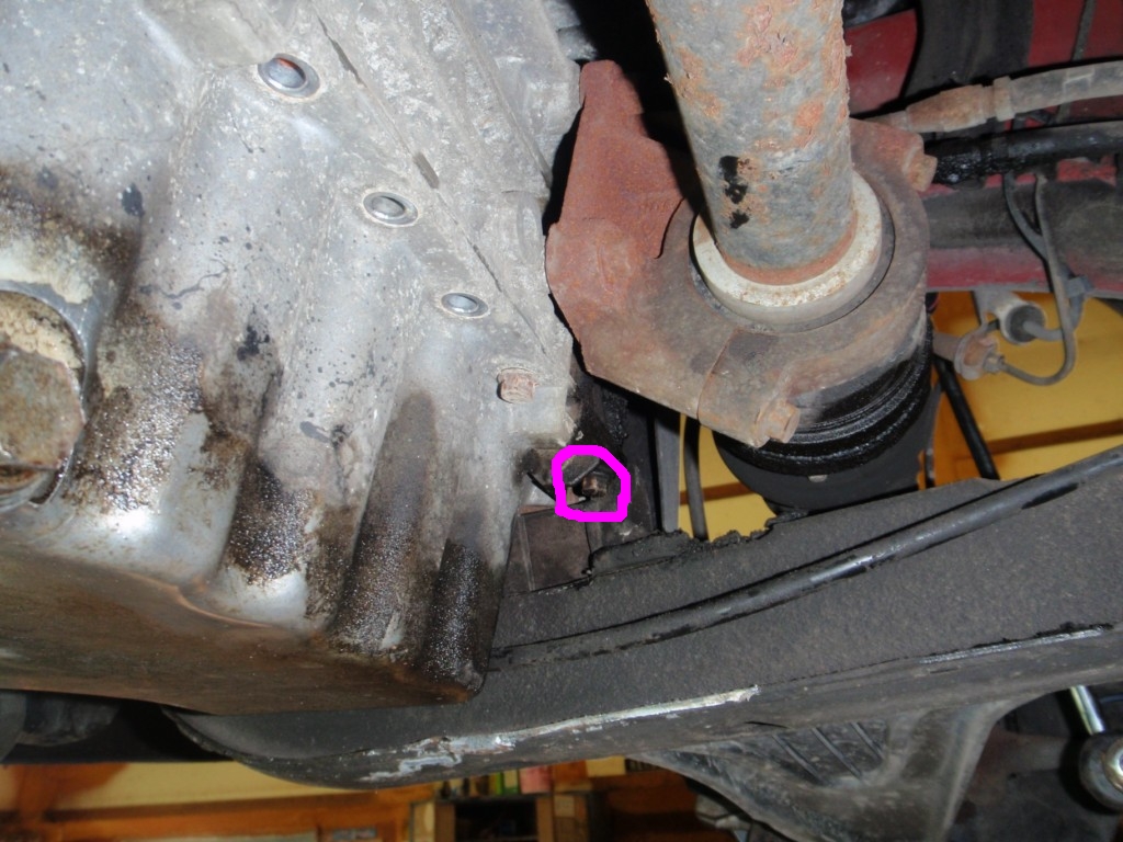

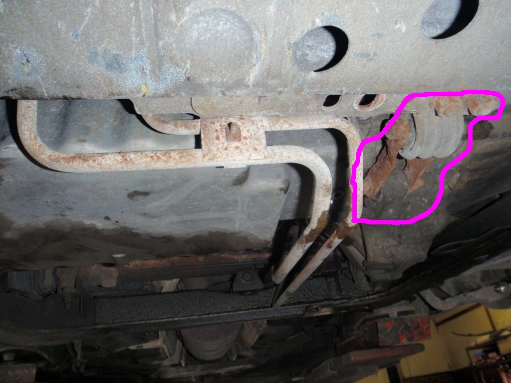

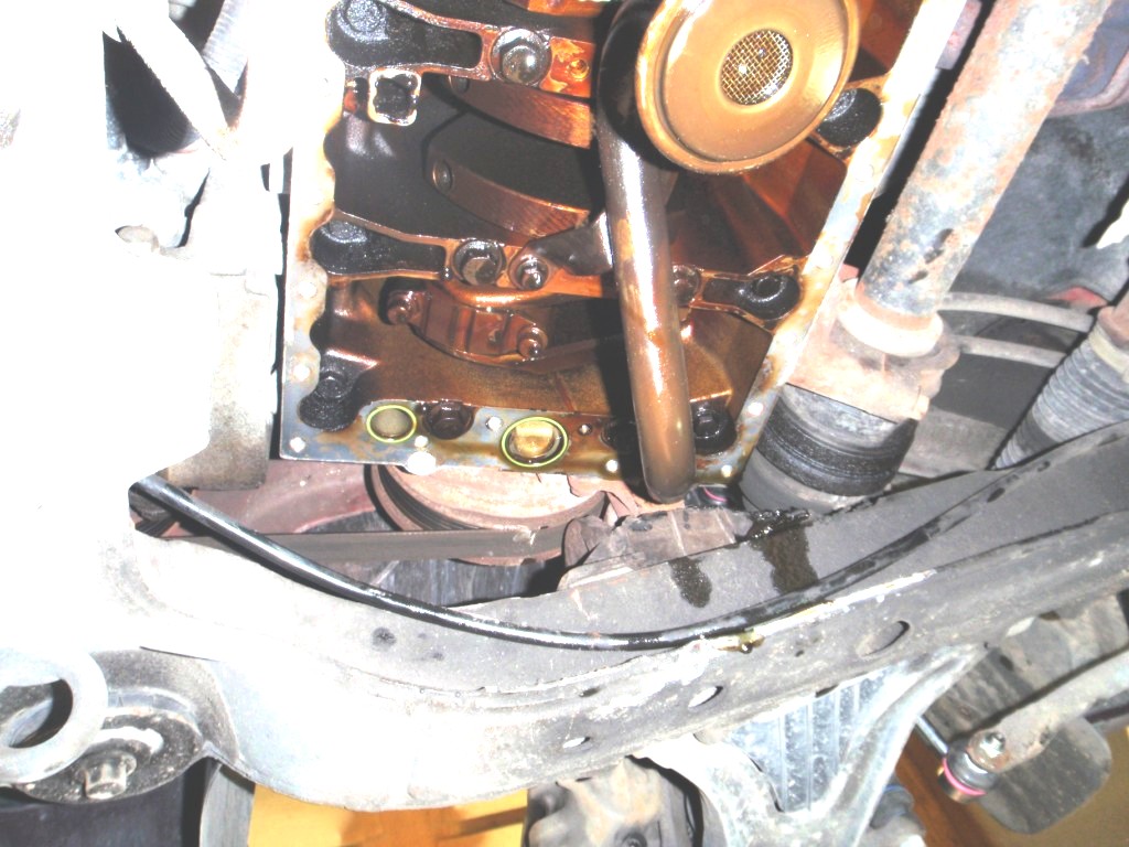

I just finished this job this morning on my '94 855 non-turbo, and thought I'd add a few details.
First off, here's what I ordered from FCP:
O-ring Kit
Dipstick O-ring
Sump sealant
From the first kit, I only used the two block-sump o-rings, and the oil pickup o-ring. The others I believe are for turbo and oil cooler, and I had neither on my car.
This was a very frustrating job, as the passenger's side of the sump is up over the subframe, the power steering lines run under the driver's side of the sump, and the oil pickup is nested down in a slot in the sump casting, limiting movement of the sump. I did manage to remove the sump with power steering lines in place, but the clamps holding the lines in place needed to be removed, and the lines bent downwards enough to allow the driver's side of the sump to drop below the bellhousing and slide left. There is also a metal tab on the passenger's side of the subframe that others have bent down to allow clearance. I took a more aggressive route and cut that tab off flush with the rest of the subframe. I also removed the transmission torque mount highlighted in magenta below. That provided extra clearance when sliding the sump towards the driver's side.
There are three different length 6mm bolts (10mm socket) holding the sump, as well as two larger 10mm bolts (14mm socket) through to the transmission. It's pretty obvious, but just to clarify, I marked the short bolt locations in yellow, long in red, and medium length in blue on the parts drawing below. All but one of the 6mm bolts can be accessed easily from below with socket on a long extension. The one that requires fiddling with a wrench is high-lighted in magenta in the pic below.
I had some difficulty convincing the sump pickup tube to go back into the block with the new square-section o-ring in place. It simply would not pass into the opening in spite of the 45deg. chamfer on that hole. I ended up breaking the sharp edge on the block between the chamfer and counterbore for the oil pickup with some emery cloth. After that, with some lube and effort, it popped nicely into place. That counterbore where the old o-ring sat was black with deposits, which seems to indicate air was being pulled through that gap. The other two block o-ring counterbores were nicely and shiny with no such deposits.
The only hint I'd give on re-assembly is to have the passenger's side wheel off, and the plastic wheel well cover open so the sump area can be seen. Once the sump is up in position, lower it down and look in this area to verify those two o-rings are still stuck up on the block as described in earlier posts. I found the large one had fallen loose, but I was able to stick it back into place working through the wheel well area. Once that's done, up it goes for final assembly.
Below are some pics showing the process.

- Oil sump bolt locations:
Magenta - large dia. bolts into bellhousing
Yellow - short (many)
Blue - medium (three) <- with sealant
Red - long (four) <- these had sealant as well. - Sump.jpg (56.91 KiB) Viewed 13535 times
- That circled one needs a combination wrench. All others can be had with socket wrench and long extension. The shiny section on the subframe is where the tab was cut away.
- PB280001.JPG (414.11 KiB) Viewed 13536 times

- Sump Removed - Two green block-sump o-rings can seen.
- PB280005.JPG (180.85 KiB) Viewed 13536 times
