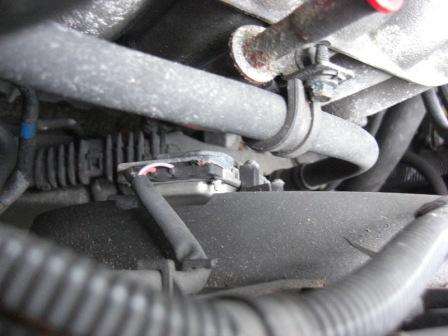

Most likely the cooling fan control module is defective. Find the wiring diagram for your model.
https://www.matthewsvolvosite.com/downlo ... 60_S80.pdf
On page 50 (pdf) you have the circuit. Fuse 11A/7 feeds the assembly. The module is 4/71. Presently it brings full power to the motor. It is kind of shorten out.
It is shown on page 155 (PDF) as a plug-in unit :o . You've the fan on page 157 (PDF).
However i have checked with mine and the module is part of the whole assembly :roll: .
Coolong fan control module.JPG (63.06 KiB) Viewed 2731 times
I think you will have to change the assembly as planned.

I have the same set up as shown in your photo.
