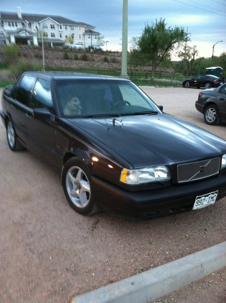

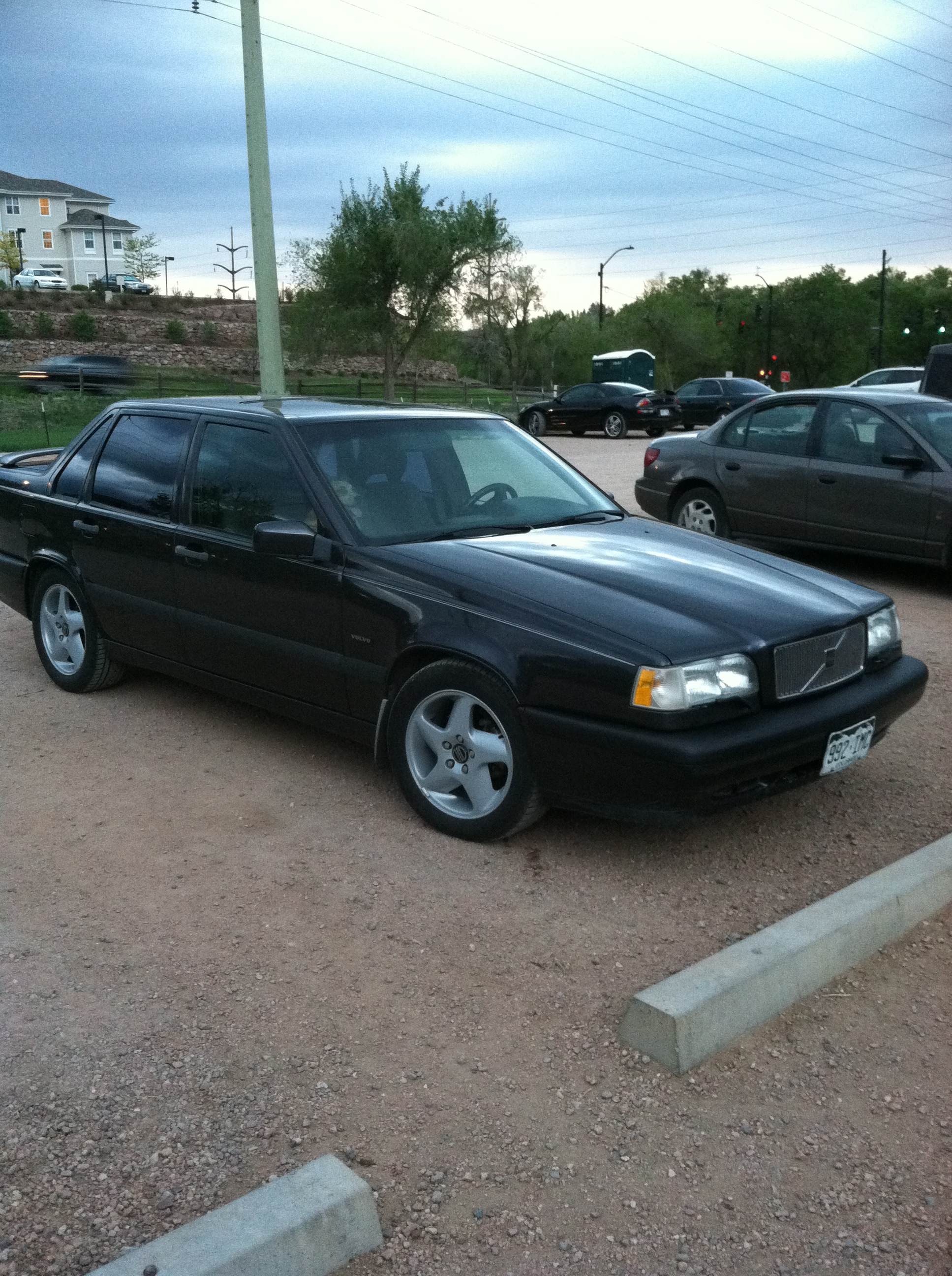

My sedan sits outside 24/7 year round. I had some bad sun "bleaching" (?) going on with the hood and the roof. I had previously painted the bumpers, roof molding, and trunk spoiler myself. The sides were not too bad. I should gotten some before photos but those bad areas were depressing me. Paint and body shops in my area need some work so I brought my car in. They took the hood off and stripped it. Also blended the front fenders in with the hood. Costs were $1,000 for roof and hood and another $300. to do the blend work. They did a great job and I am happy.
