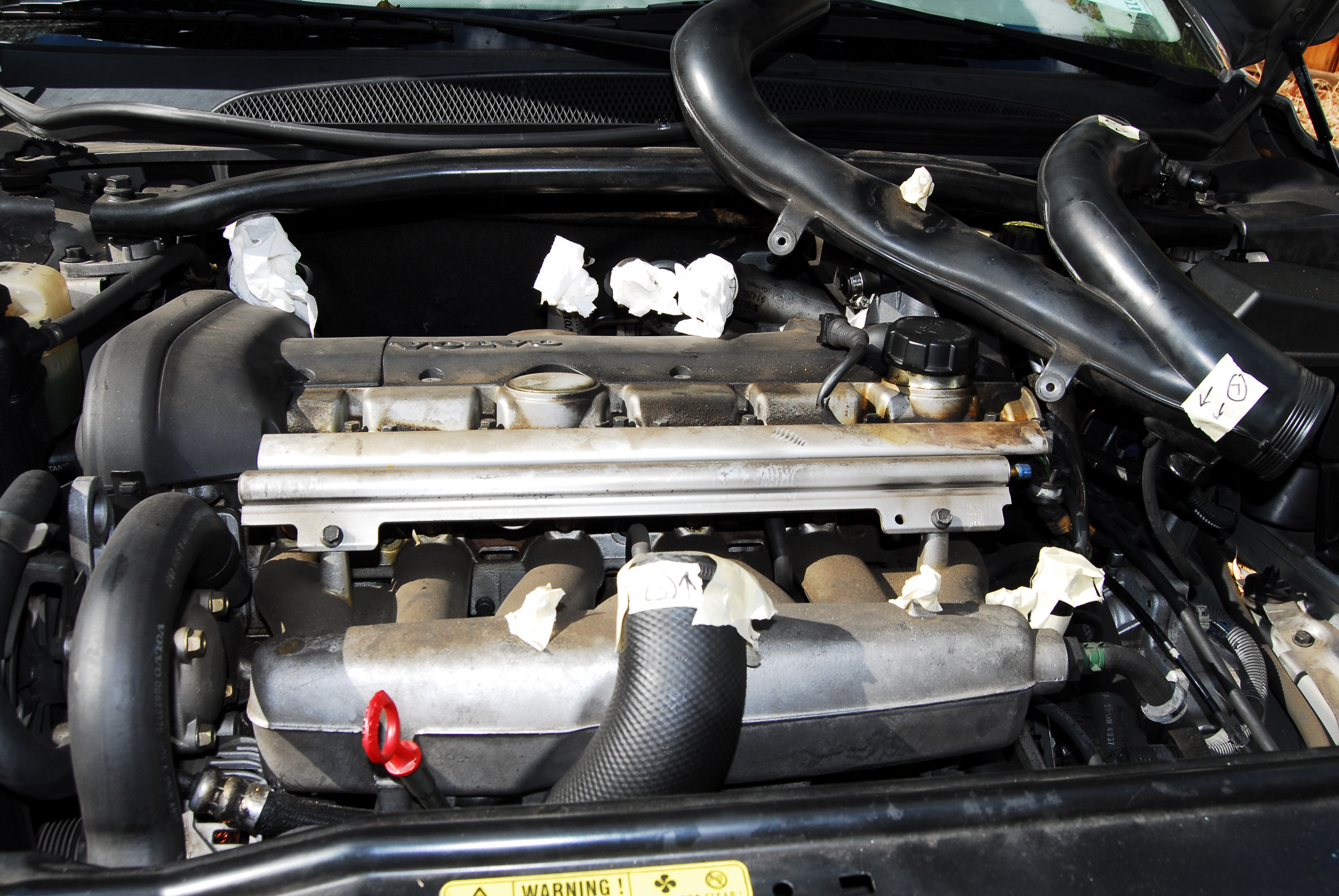

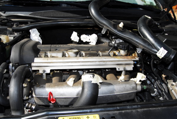

Hello,
Today I began to remove parts from the top. I understand that I have to remove fuel rail system and intake manifold, to get to oil trap.
Could anyone provide instruction on removing the fuel rail? (Picture attached.) I was told to turn the blue knob in the middle with cloth, to catch dripping fuel first.
- Any things to watch out for draining fuel?
- Which ones and where should I unscrew?
I read Vadis instruction but it was not too detailed.
Also I would appreciate full instruction in following steps.

On my '99 there was nothing to turn to separate the fuel pump. I had to use a tool from Autozone. I think it was $7. AC and fuel line separator tool.
Looks something like this:
