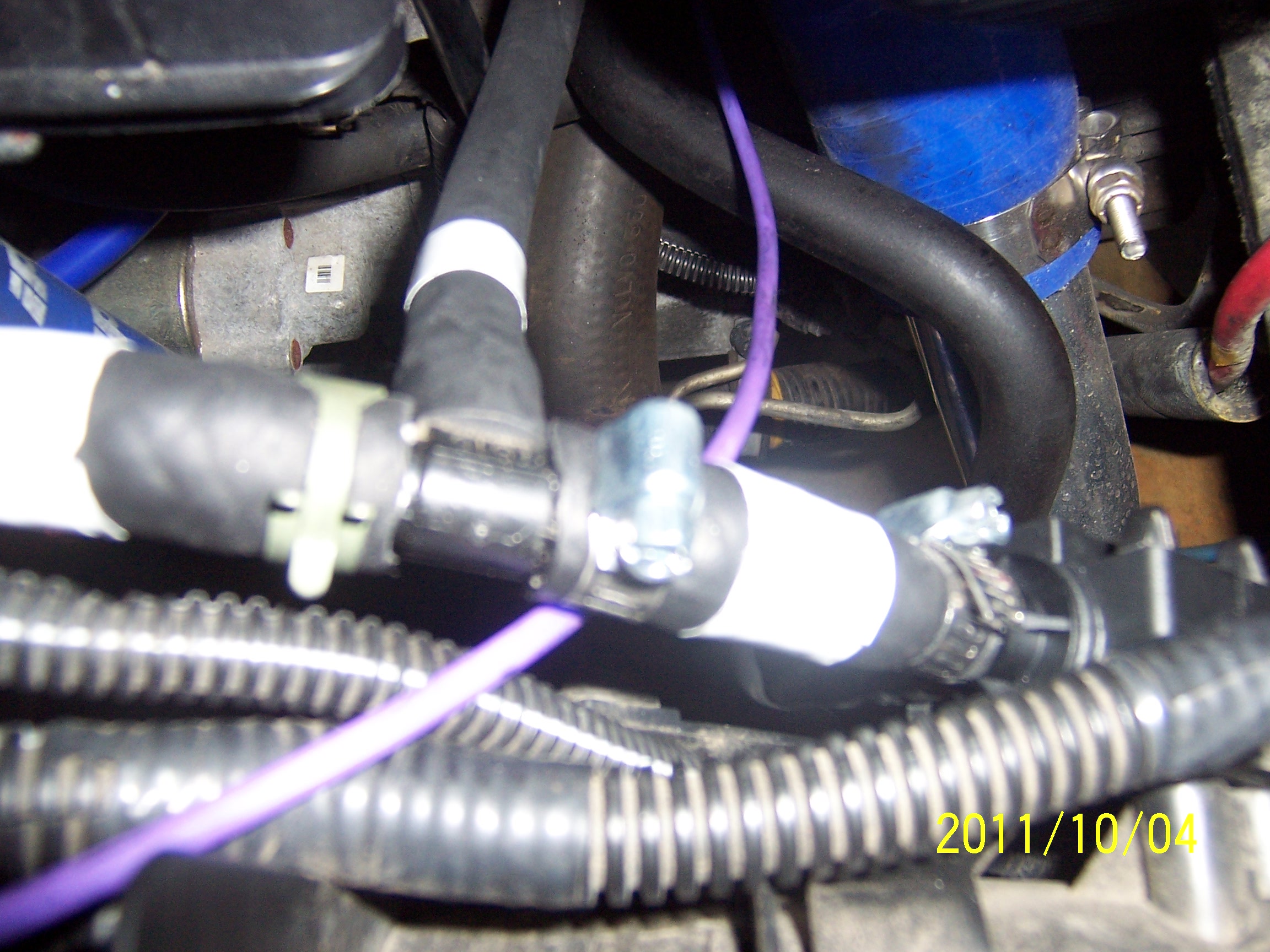

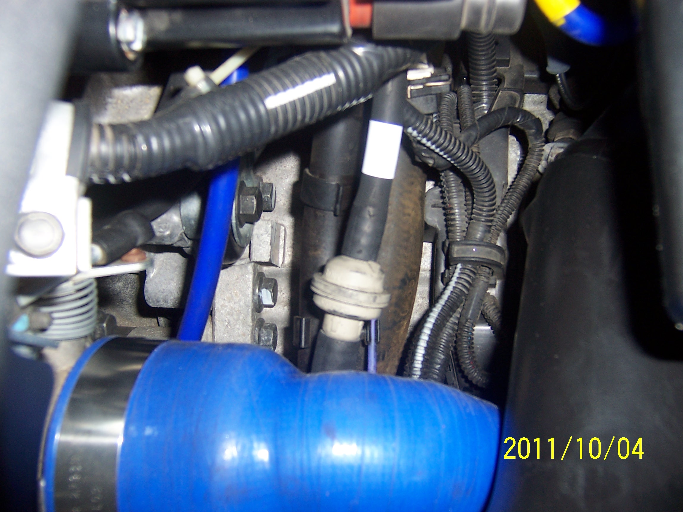

Just finished the Pcv replacement and took about 6 -7 hours (with my nine year old daughter) to complete. car started right up and threw the above code... had no codes before and only this one now. I suspect this is because some wiring connector was not matched with it's mate, as there is 1 connector left that I cannot find the other side of. So here's where you all come in!
This is a small connector the is close to the battery(neg side) and does not reach more than 6 inches into the engine compartment. I'm hoping someone out there can point this out as it must be so obvious I can not see it. HELP!!! this will make the job DONE.

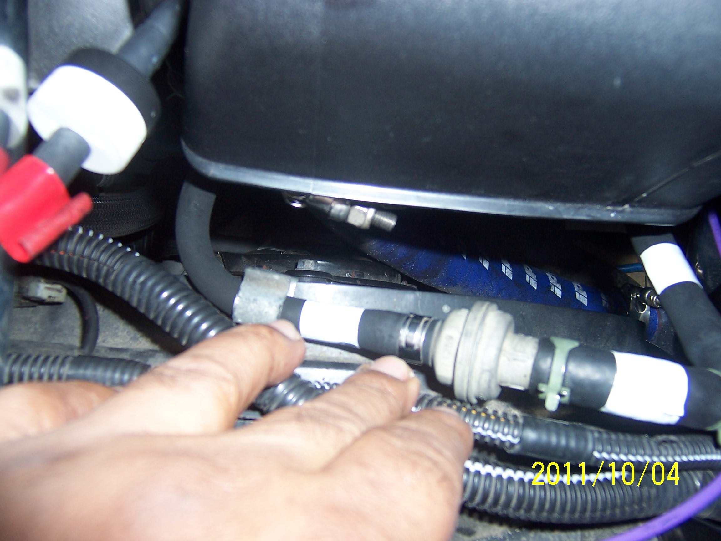

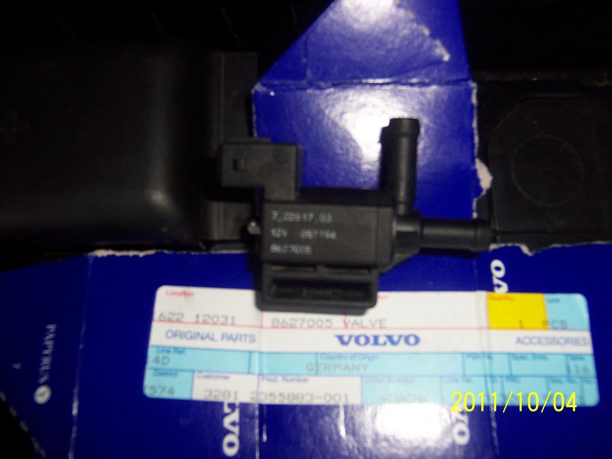

If your speaking fo a vacuum line and electrical connecter near driver side fender, (neg battery) side, that tells me Purge Check valve. On the drivers side, front, radiator shroud, remove the big plastic air tube (connects to the airbox, bottom too.
Now, look under where the tube was, you see a Purge valve...has small vacumm lines connections and electrical conections.
