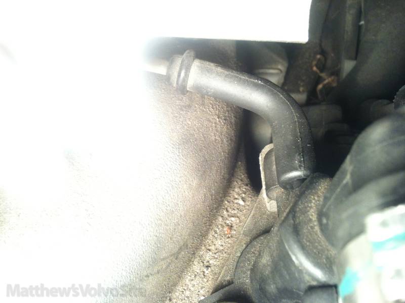

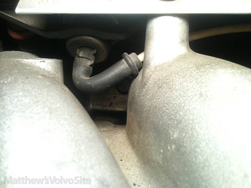

And the evil elbow under the intake. Another shot. Evil.

And the evil elbow under the intake. Looks good.

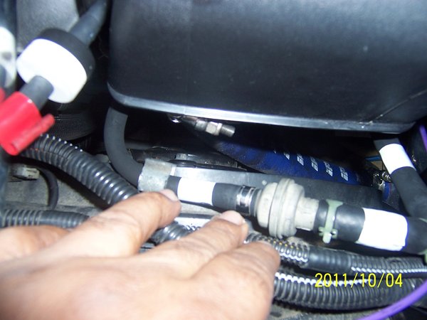

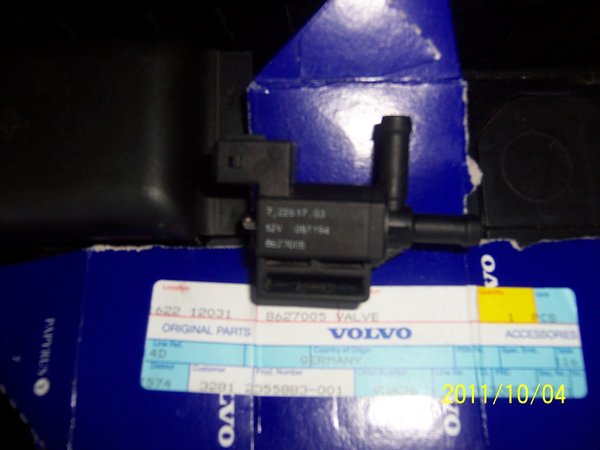

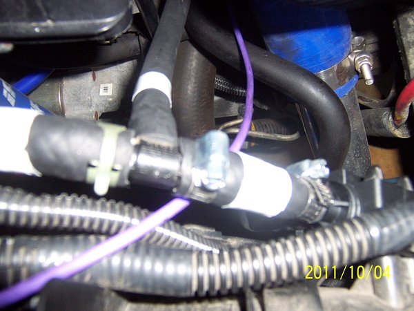

I have replaced: both j-hoses on the EVAP canister, fuel filler cap 3x, fuel filter numerous times, elbows, vacuum lines, and recently this Purge Check Valve near radiator shroud and in front of battery. After more than 200 miles, I still get a P0422 small leak, but I will be replacing this T-shape system (I was told by FCP Groton it comes as a complete kit). If this does not fix my problem permanently, the next thing is to go back to the EVAP canister...there is a Purge Valve that looks similar to the check valve, but more expensive.
Your Purge Check Valve may be round or rectangle, by Peirberg or Denso.

Mine's round. $80-ish for replacement, already looked into itJuan62 wrote:Your Purge Check Valve may be round or rectangle, by Peirberg or Denso.
