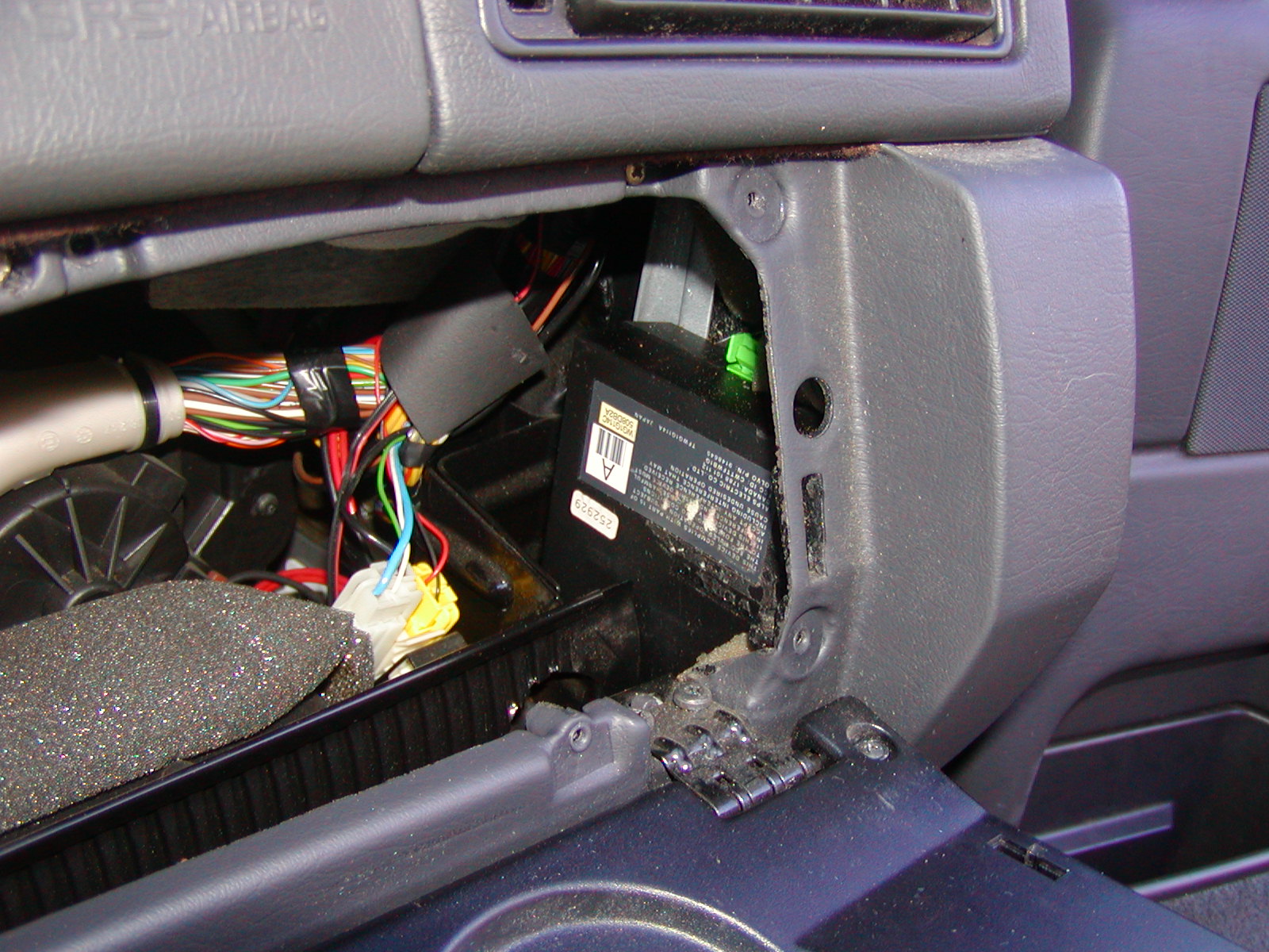

If the car has the remote receiver you can just buy the keyfobs and program them - which is very easy.
To determine if you have the remote receiver or not you need to remove the glove box and look along the A-pillar for the receiver box. This one is upside down but it is in the correct location.
If you have the receiver get the part number and FCC identifier off of the receiver so that you can get the matching remotes. There are two different models that look identical but they don't work unless they are the same series.

It is indeed that box but ignore all of the big numbers on it - look at the smaller numbers that specifically are called out as PN and FCC. Those numbers are often covered with tape.alexk243 wrote:Awesome, Thanks. I am assuming the box with the "A" on it is the receiver box.
