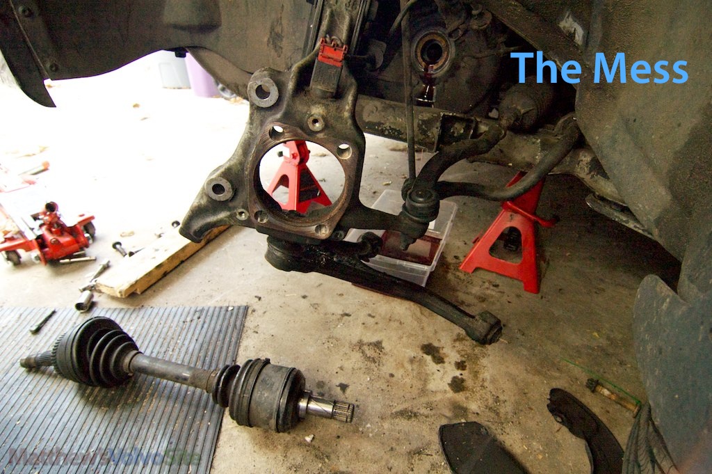

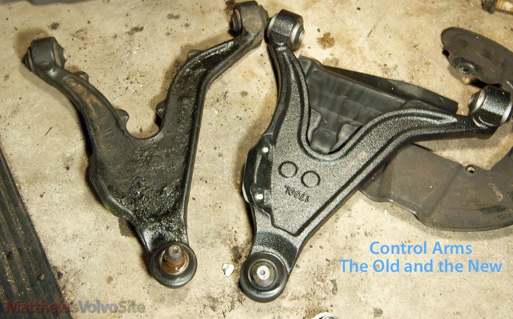

By the way, I didn't just finish. I finished at 7pm MST and called it a day. Here's the pics:

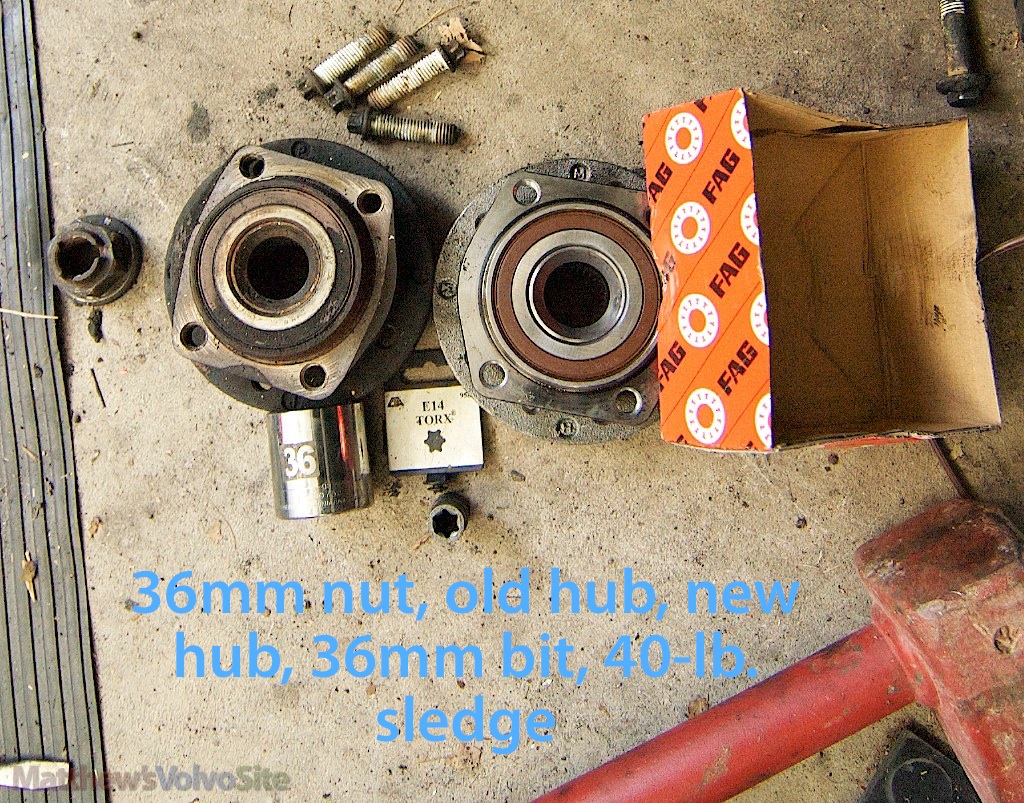

Man am I having a heck of a time getting off the 36mm nut

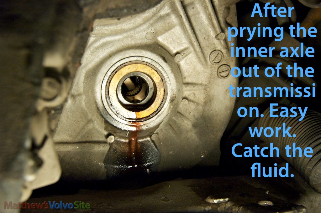

- Pry bars. This was actually the easiest of everything I did. The inner axle just popped out.
- 850-suspension-rare-expensive-prybars.jpg (181.97 KiB) Viewed 2004 times

Obayha, the hub was going bad. Whump whump whump as I turned right, meaning my left hub, or one of them, was going. At 250k+ miles you might want to do preventative hub replacement, but they're not in the preventative maintenance price league at $100-ish times four.
My mistake was to ruin the axle by hammering it too hard with too hard a sledge. Perhaps they make 40lb. rubber hammers and this wouldn't have happened if I'd used one.
Without my mistake, things might have gone just fine, and much faster. I would have done the control arm and axle in a few weeks, after increasing my toolset properly, for the jobs.
