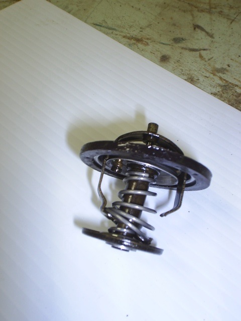

Thanks for the words of advice. It was the t stat.
I've attached a pic and you can see where the bracket broke.
Put in a new OEM unit (wahler) and it's running fine again.
The DOM stamped on the old one was 08 03 so it must have been changed by the previous owners
at some point as well.
The old unit was also a wahler unit. It was a pretty easy project and I changed the antifreeze while at it.
Thanks to my good neighbor Pete, who has an awesome set of just about any tool needed. He had the right size torx bit for the housing bolts..T.
