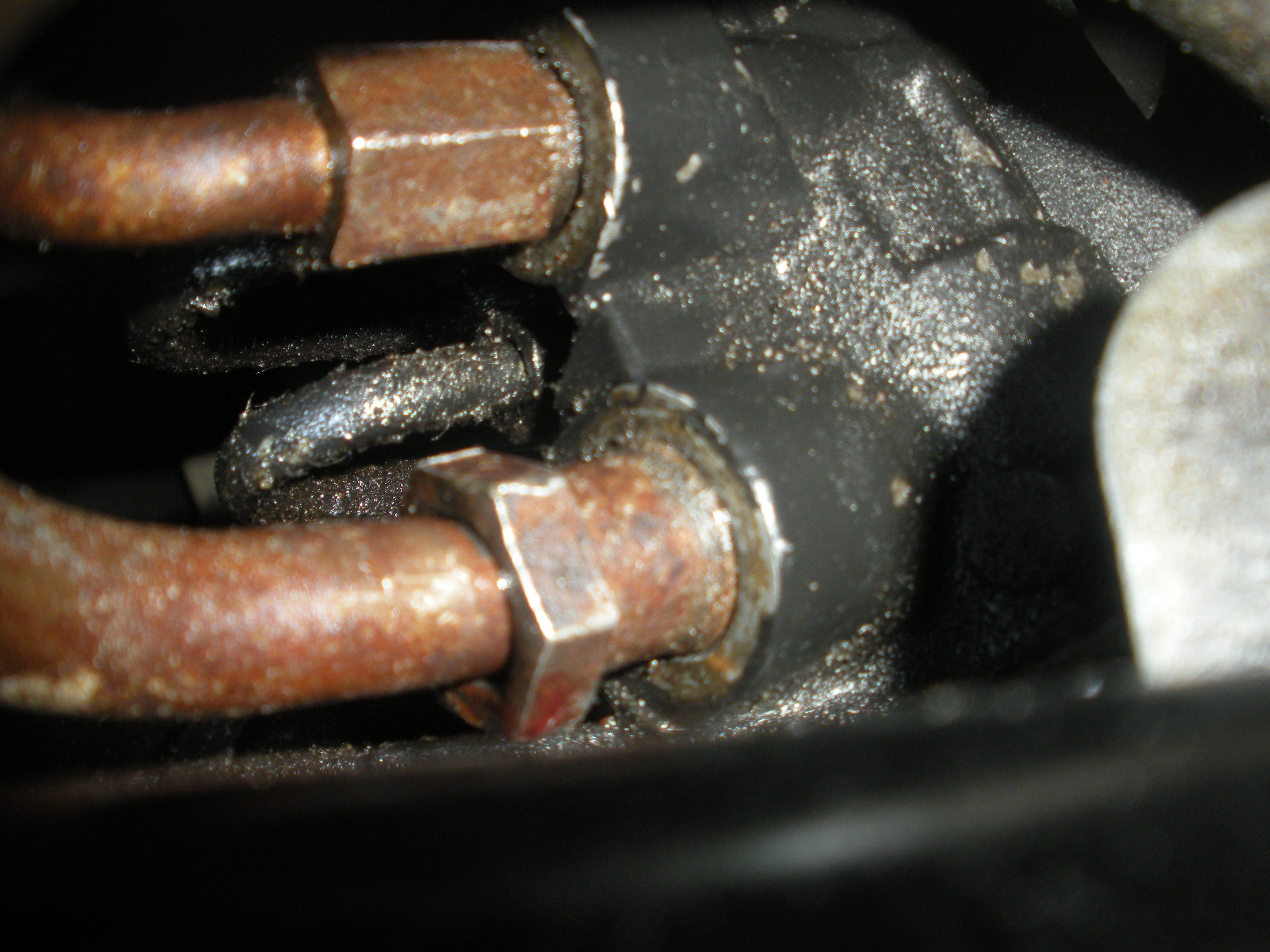

The first time I put the car on ramps, I noticed that the bottom line that hooks up to the rack (the return line?) seemed to be leaking. But it was weird. The hose looked fine and I tried tightening it further, but it wouldn't budge, so I think it was tight. The fluid seems to go through the nut that is built into the line, but is not leaking before or after the nut (If that makes sense, I can try to put a picture up). How hard is it to replace the power steering lines?

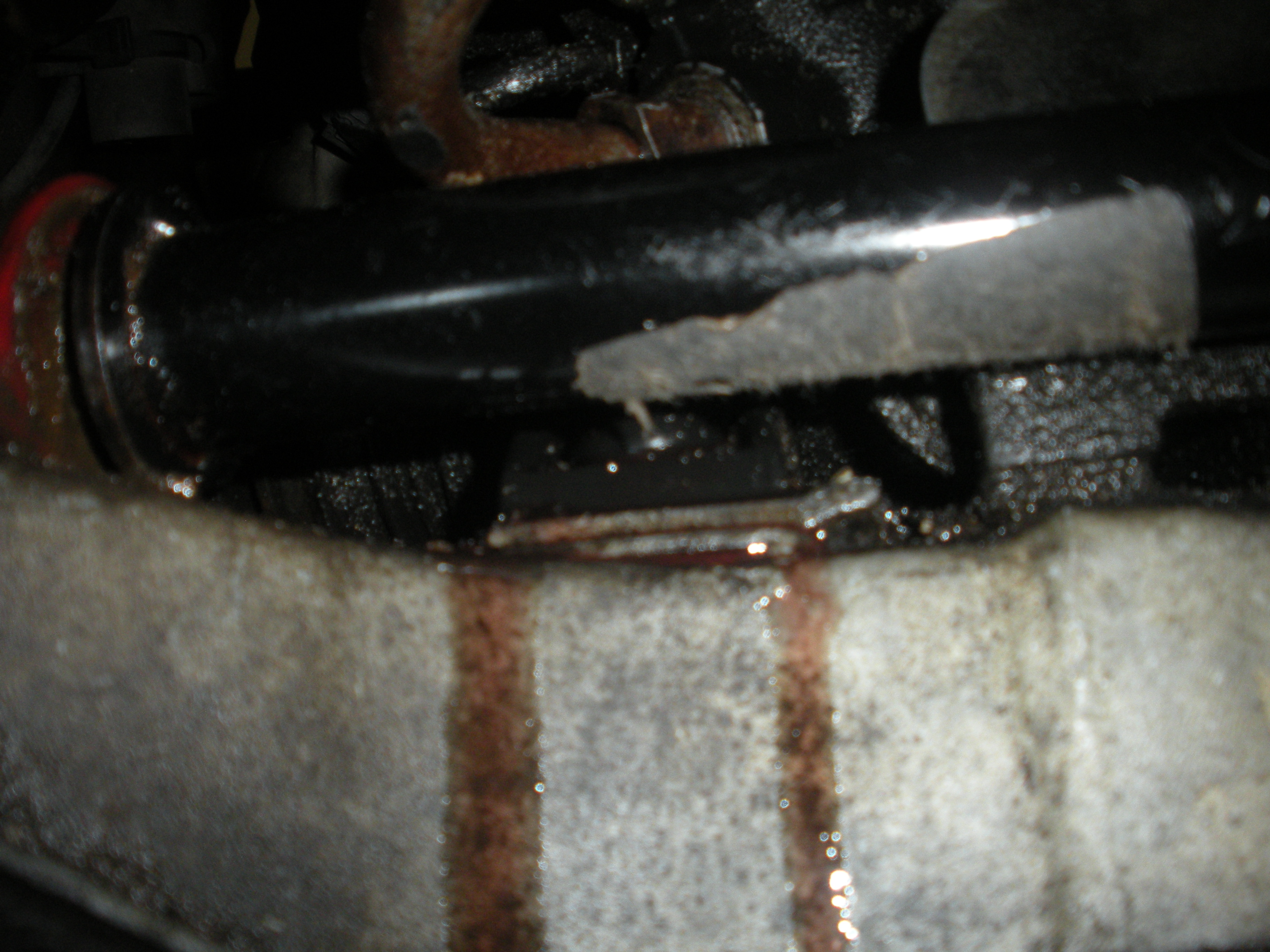

I have attached two pictures. In the first picture the bottom hose is what looks like it is leaking. But it is leaking from between the nut and the hose. Does that mean the hose is broken? It is not leaking in front of or behind the nut.
The second picture just shows the fluid drip.

From the pictures the line is cocked at a funny angle. It may be that you can get the flare nut off (usually not easy) and re align the tube to seal the leak.
Beyond the standard rusty bolt and the fact that it is a flare fitting problems it really isn't that hard of a job. As I recall there is a clamp that holds the hard lines in place near the rack but the rest of it justs fits into place.
My guess is the hardest part will be on your wallet to buy a new line if you need one. I have not priced those lines but an oil cooler line for my daughter's S70 set me back around $125.00 and it is a much simpler line.

I just had those apart so remember them well, they are a "spigot" type fitting sealed with an O ring, not flares (O rings are number 10 and 12 on the diagram below). The diagram doesn't show it well, but the end of the tube is straight for about 1/4" then an annular ring is pressed into the tube which is what the nut pushes against when tightened. The O ring goes on the tip end of the tube and seals against the top of the bore that the short tip of tubing fits into. This design is what allows the leak to be seen coming from the center of the nut - if the O ring leaks the clearance between the hole in the nut and the outside diameter of the tube is the path of least resistance to the outside world; otherwise the leaking fluid would have to squeeze through the space between the threads.
The O rings are different sizes, I just used the best fit from my handy dandy Harbor Freight metric EPDM O ring assortment. It hard to tell only from your pictures but it looks like the return, low pressure line (bigger diameter) is the one leaking.
I'd bet a bad O ring is the problem and certainly if you take the tube off you should replace them. Not really too much under there that can damage the steel tubing, usually these type of hose/tube assemblies fail when they start leaking where the tubing joins the hose part, and that is forward by the radiator (or "raaaadiator" as they say here in Jersey - funny they pronounce radiator correctly when they are talking about the steam radiator in a building...). But given the apparent misalignment coming out of the nut, the tubing could have cracked where the annular ring is pressed into it.
As Lee says about clamps, there are two that hold the tubes in position, I think the rear-most one fastens to the rack itself and another one that is a bracket affair bolted to the forward part of the subframe, and mine has another band clamp under the oil pan that just keeps the two tubes held together. So long as you have room to work under there and the right size 1/4" drive Torx bit they shouldn't be too much of a problem. Of course to state the obvious, you will need to loosen these clamps to pull the tubes out of their fitting in the rack.
