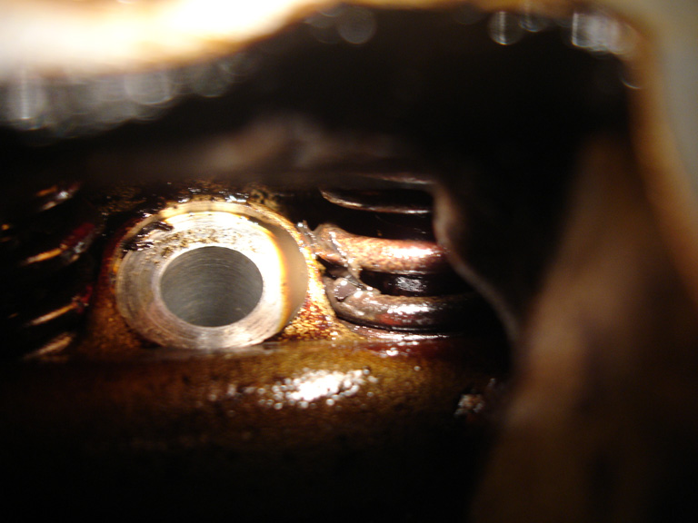

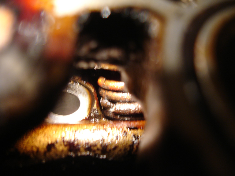

I know my posts are a bit long so to recap: cam cover is off, head is still in the car. It looks like a broken valve spring because one of the valve spring seats is slack.
But without a Schley or other tool I can't check that. So I am sort of stuck while I look for a tool. Hesitant to spend $130 on a tool for one lousy valve spring ... looking into making one a la Gilhuly's posts.
EDIT: OK I can see the broken spring, I got out a good flashlight and peered into the upper head. Definitely a broken valve spring. Figuring out a valve spring tool.

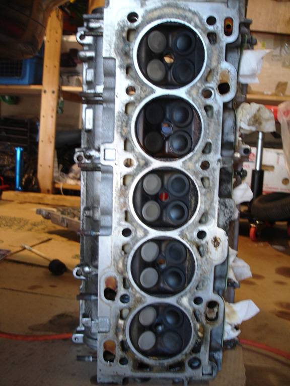

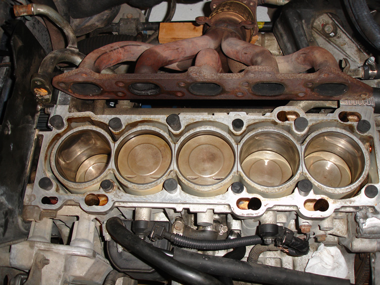

OK completed the head swap last night, seemed to go well. This time I fabricated the cam holder tool to hold the back end of the cams into the cam cover, it is worth the investment. Now I have a 100k head sitting on the workbench with just a broken vale spring ...
Engine is running smoothly though is sounds more "clicky" up top than I remember.
A few pics as promised.
Will see how it runs the next few days ...

- The block, midway through the cleaning process. The top of #2 did not seem to have piston-valve contact. With the broken spring, the exhaust valve was sitting open.

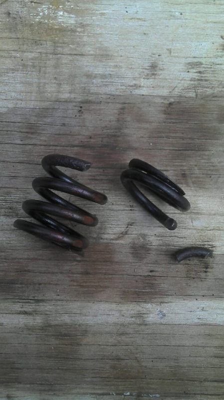

Took the head to a machine shop and had them swap the spring from my 93 head to this head. No issues there. These guys gave me a good deal (in comparison for me buying the proper tool and the assumption it was going to be the one spring) (82.50 for the spring swap, resurfacing and for the hot water cleaning dump thing). Good deal if you ask me, since we were unsure if it was really flat or not.
But, they let me keep the spring, so i figured i would show you guys and see what you think. I am worried that another spring is going to break eventually after viewing these pictures, but since i have the 93 head as a donor, i just need to get the proper tools. I can change valve stem seals at the same time
Yea yea i didn't do it on this head, but it is pretty clean on the outside and i think other then the sludge and seeing these pictures, it'll be fine.

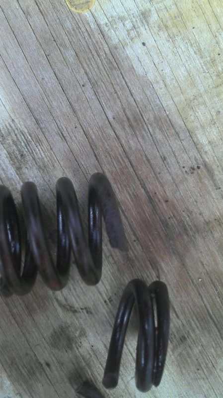

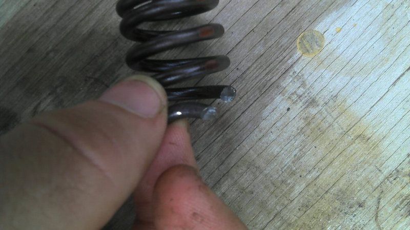

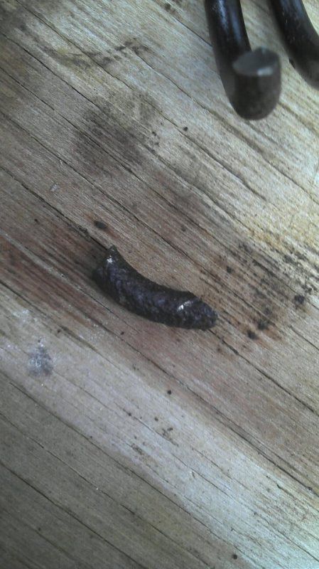

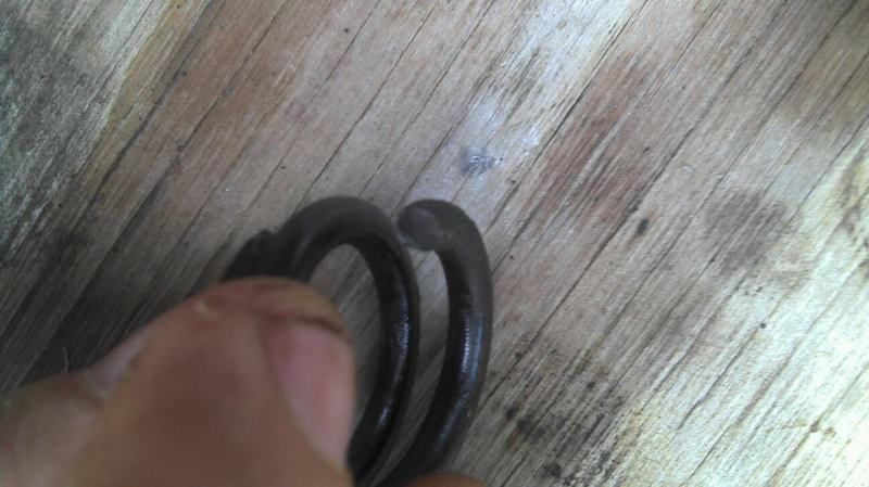

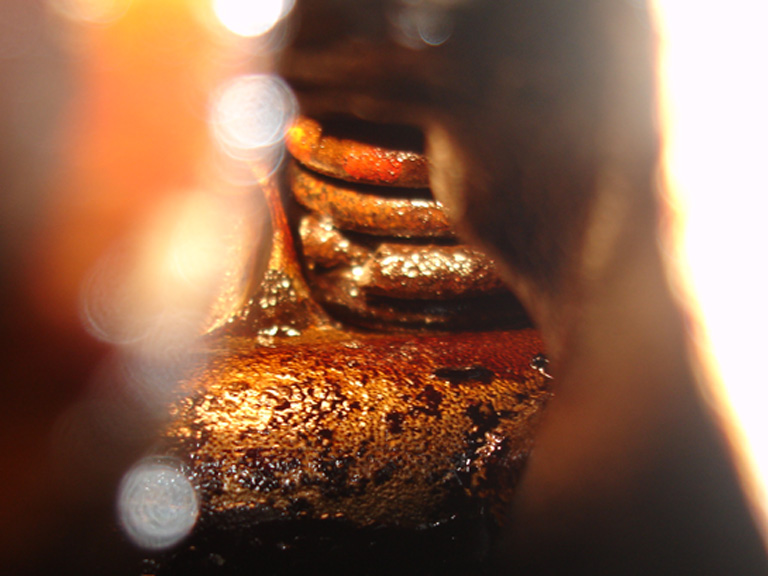

So here is the spring. You can see a piece of it broke off. I'm very glad i did get this resurfaced and cleaned, because i might have spent forever looking for the piece or any shards of it.
The pictures show it in 3 pieces. I tried to show the ends of it, and the metal looks clean on the outside.
The surface however, is what has me cautious. It appears to be 'speckled' like when something starts to rust. I'm not sure how clear it is in the pictures. If this is the case, does that mean more then likely ALL the valves are like this? If you look in the pictures above you can kinda see where this one broke is where the metal looks speckled, and on one of the good valves it shows some of this speckling too.
Anyways, i have never heard of valve springs breaking on these engines, so i figured this would be a good way to show that it can happen. Hopefully that will be the first and the last time i see or hear of it though

It looks like a little carbon buildup maybe? Might want to soak that in a cup of carb cleaner overnight and see if it comes off.
