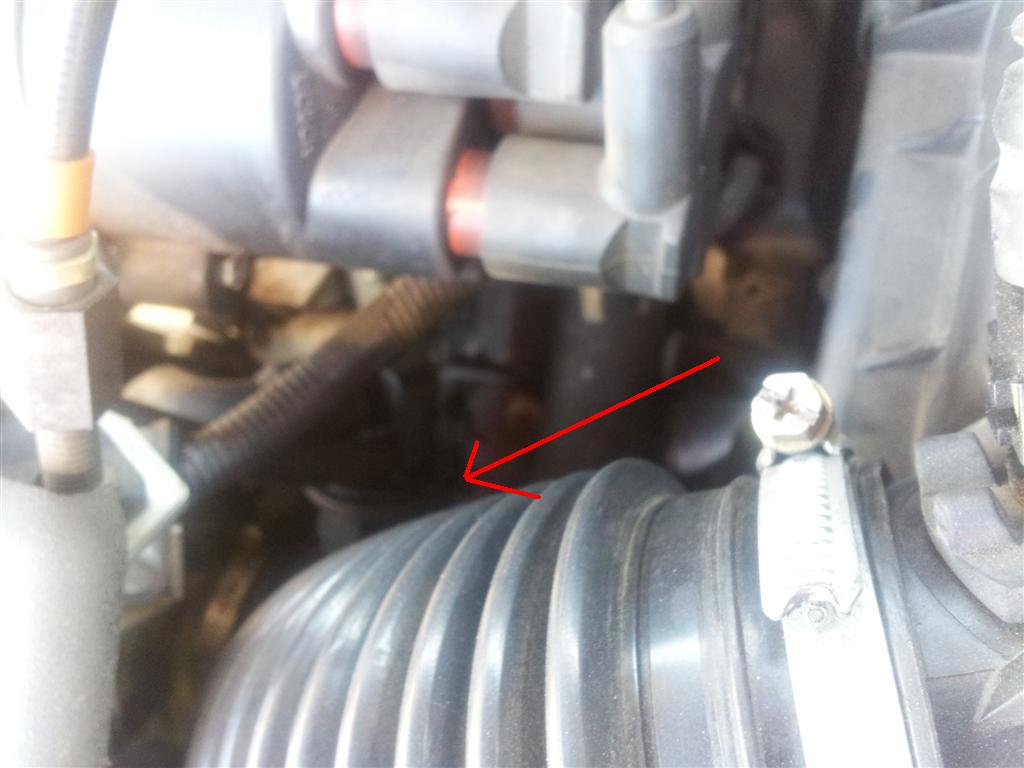

It is a complex system. On NA models there is a flame trap located in this assembly as per photo.
There are also various hoses which lead to a large plastic collection box under the inlet manifold which is bolted to the block. The ports on the cylinder block which lead to this collection box can become clogged and cause excess pressure to vent through the dipstick tube and through seals which result in leaks.
Remove the flame trap, check it for clogging and clean it (some users remove the flame trap mesh totally)
If you have a lot of pressure through the dipstick tube after cleaning this it will be time for an overhaul of this system.

I didn't know if the volvo's had a specific pcv valve as other vehicles do. For some reason, after he jumped the vacuum lines together on the evap canisters, just for a short test drive to see if that was causing the performance issues, the dipstick and oil cap were smoking. It seems strange it happened right afterwards. I am going to go ahead and take apart the whole pcv system and clean it up if cleaning the flame trap is ineffective. Thanks
