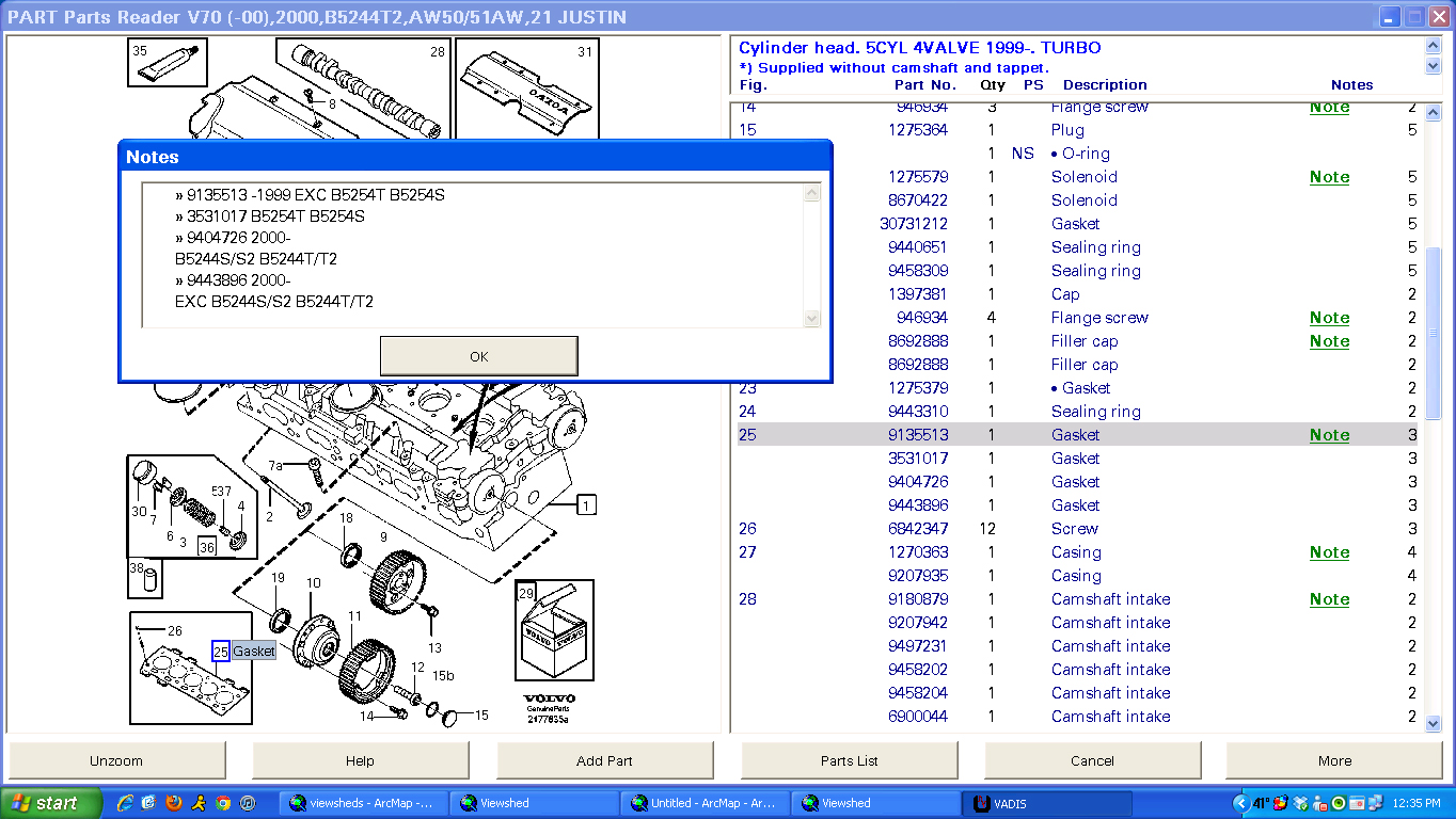

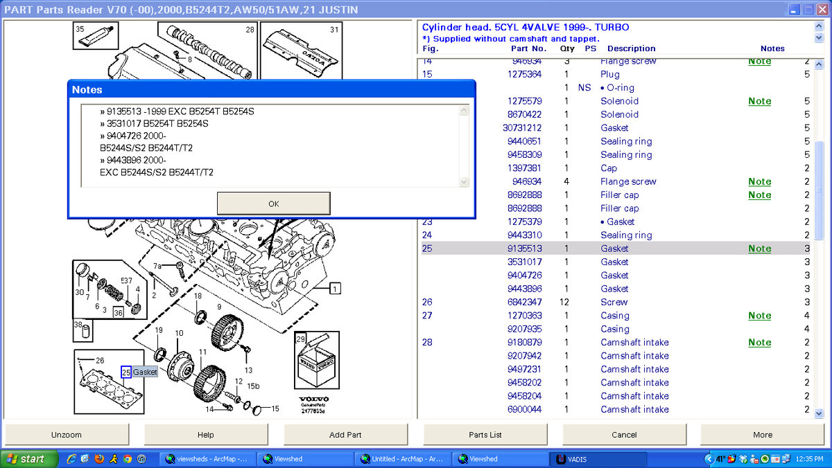

It looks like the information you're searching for is in the numbers.
The correct gasket for your engine is 9404726.

In other words; they do carry it - but it's the same as the non-turbo engine rather than the 2.3T engine.
