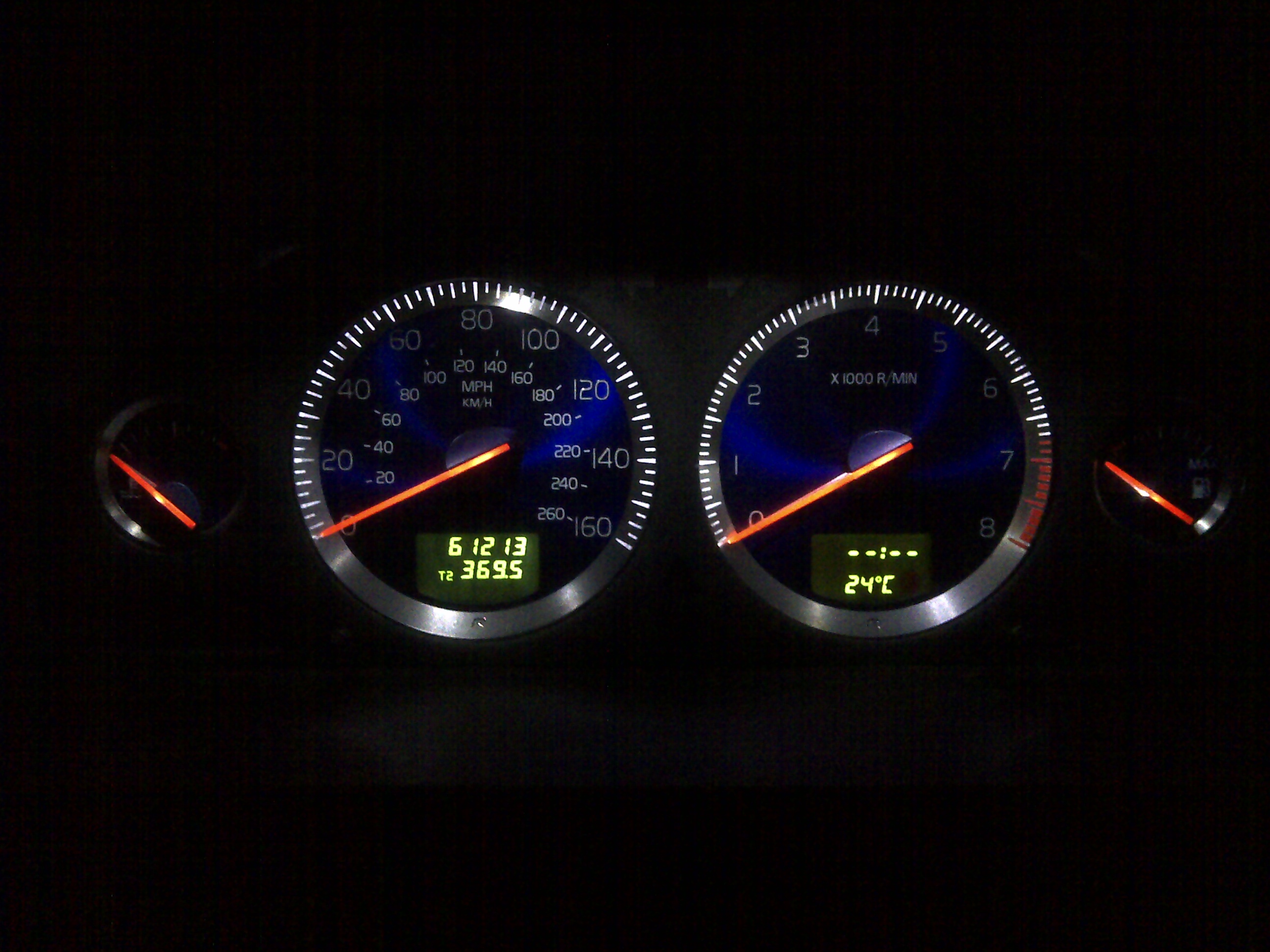

Hi, here is a quick summary:lasthumain wrote:normaly they have the same plugs but the problem the blue cluster may came from V8. do you have V8 too if yes i think yes it ll work. if you did it already can you let me know if it did work for you and where did you get the cluster from ? i m looking for one.
1. Due to I didn´t find the XC90 R-Design blue cluster used, I had to purchase the blue one for S60R (my risk) on ebay
2. When I received the blue cluster for S60R, I dissasembled it and took out the 4 blue gauges with 4 needles (of course I must tried to handle this cluster first due to this was my first time doing this!)
3. I removed the original black standard style cluster from my XC90, then the same procedure that #2.
4. ¨Simply¨ replaced the blue ones on the standard black cluster. The gauges are easy to install BUT you must have to be accurate with the needles because if you don´t, they will be as ¨uncalibrated¨, I mean, if the SUV engine is ON but stopped the speed gauge would indicates 60mph or if you know your fuel tank is full, the needle would indicates 1/2 tank (these are examples).
5. THE PROBLEM: I didn´t note the difference of the material between the standard black and blue gauges, the black ones are made of a translucent material, and the blue ones are made of aluminum. So when I ¨simply¨ installed the same black cluster BUT with the R-Design blue gauges on my SUV, I noticed this!: Think driving with this cluster at night!!!
6. So: I checked again the original remaining parts of the S60R blue cluster and found that for the R-Design models the cluster have some LED lights on top of each gauge (1 for temp, 2 for mph, 2 for rpm, 1 for fuel), so: the main connector of the S60R is different for my Xc90´s... but you must never give up! and think on a solution...
7. SOLUTION AND HOW IT WORKS NOW: I removed the installed black cluster with the blue gauges (¨simply¨ installed...) and took the:
- Original connector/electronic board (with blue gauges and needles installed)
- The black bezel that the original S60R cluster have: because this bezel is the one and only that can carry the oem Led lights
- The front glass that came with the S60R cluster
Basically, I made one cluster of two!.
8. Now the modification to make the leds turns on and off: only if you have seen a R-design cluster you must know that there is a special small connector that comes from all the led lights to the electronic board of the cluster directly, of course our standard style cluster doesn´t have that ¨added¨ small connector, so simply cut the small connector and you will have both cables without male connector that can be welded to a switch or to the side marker lights (as I did).
9. FINALLY: I welded both cables coming from the LEDs to a piece of cable bought at any electric/electronic shop, then welded this 2 ends to the left side marker light, and it´s done!!!: This way, when I am driving from morning to early afternoon, the cluster is like first picture, but you can see the gauges and all the items perfectly, you don´t need the leds at that time, but when night comes I simply turn on my side marker lights and instantaneously I have my cluster like the 2nd picture.
1 complete working day... but it looks great at night. BTW, this was made on a XC90 2004 T6. Hope this is helpful for all!
Rgds.
