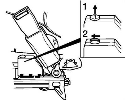

A little more information from my data book - mechanical pre-tensioners were fitted as standard from 1994. Look just in front of the seat belt buckle and you should see the pre-tensioner. If the vehicle is fitted with SRS then there has to be a warning light on the dash which should light up as you switch on the ignition and go out after 10 seconds.

My data book shows that on the 460 up to 1993 a driver's side airbag was optional. From 1964 the driver's airbag was standard. The airbag location(s) are marked by the inscription SRS. An airbag label was also located in the glove box and another on the windscreen. Of course labels can disappear but the SRS on the steering wheel......?
