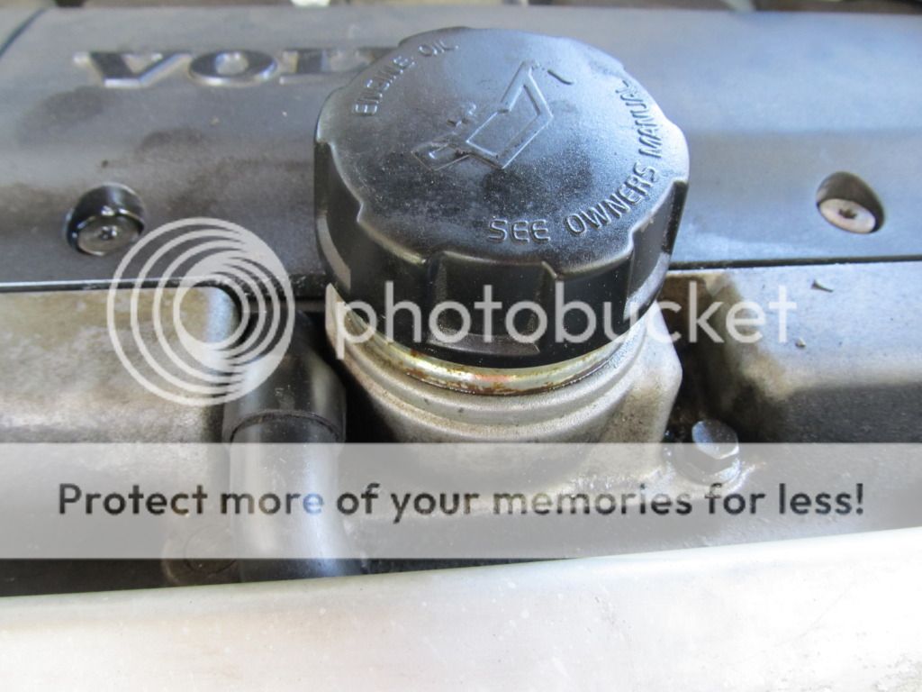

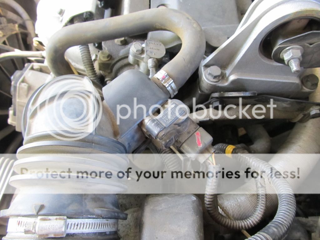

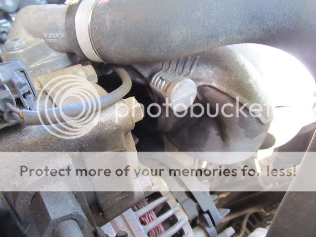

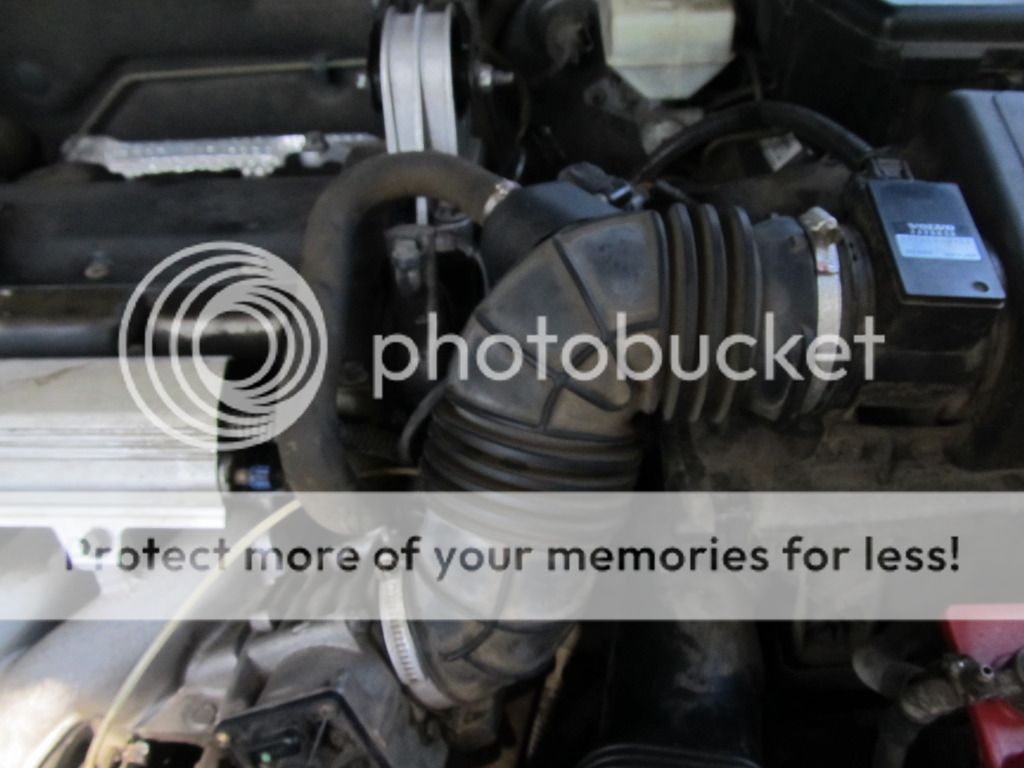

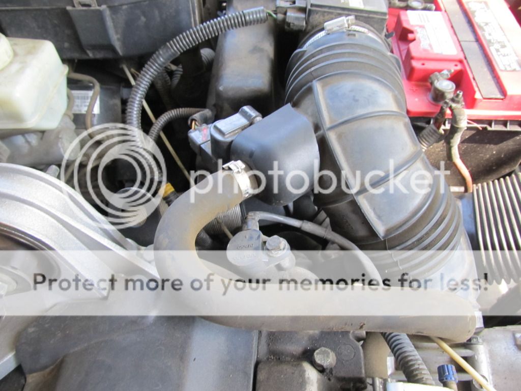

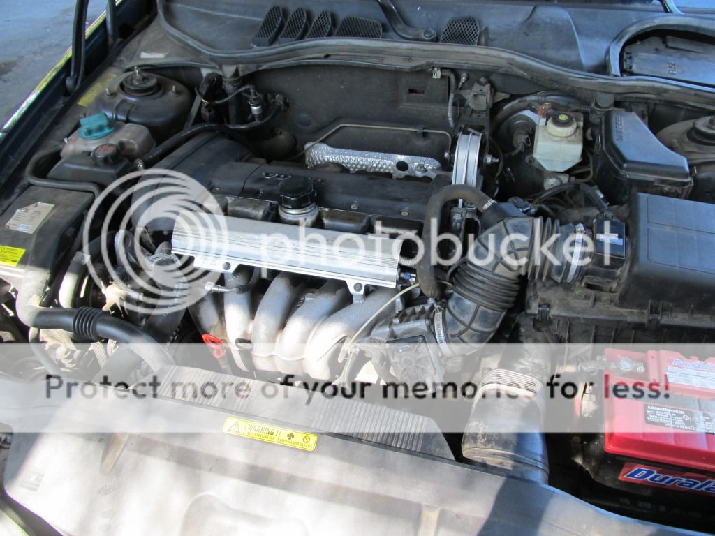

Went out and checked. No flame trap or anything resembling one. For whatever reason none of the diagrams or pictures match what mine looks like. They're close and will be helpful when I do the PCV, but somethings are not matching up and confusing me a bit. So for simplicities sake I'm just going to post pictures of under the hood.

Looks like that's it.
