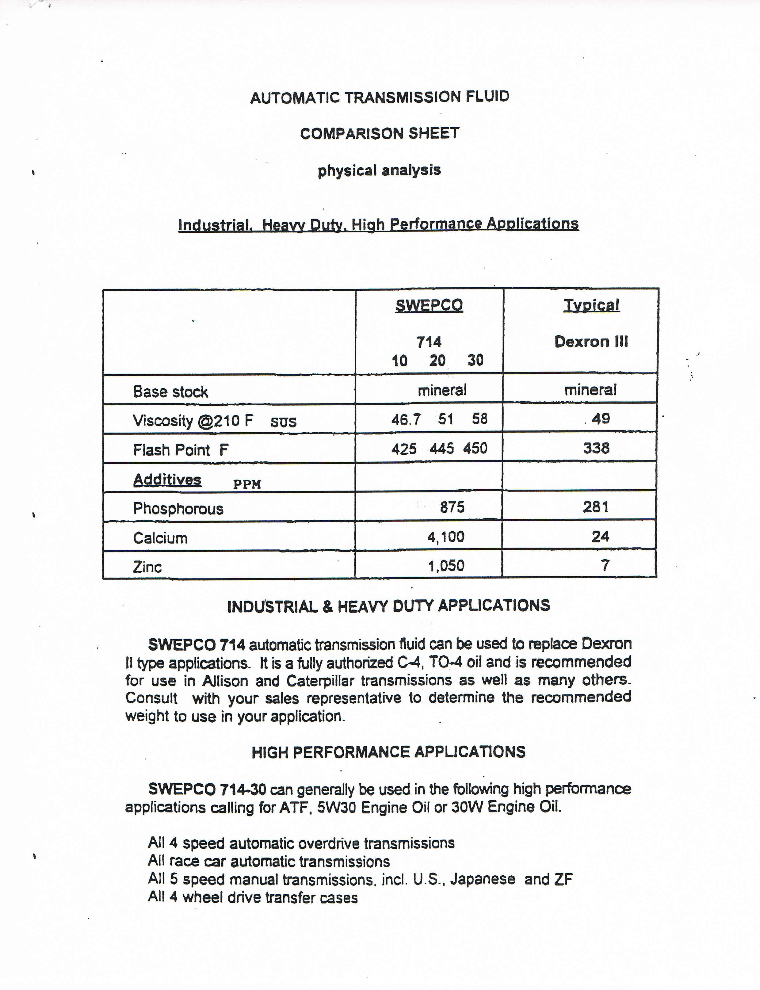

Depending on the condition of your transmission and frequency of service you can: Drain and Fill, DYI Flush with all three or use Swepco as it will have the most complete additive package to keep a worn of almost dead transmission alive. 20W 714 Swepco.dongwenxuan wrote:Hmm So we actually have three different ATF for these cars?

I've been using 714 20W for over a decade and Swepco does not advertise as they do not need to due to it's customer base and then some!
http://www.peachparts.com/shopforum/per ... etics.html
http://www.bobistheoilguy.com/forums/ub ... er=2364640
http://www.swepcousa.com/lubesite/lubep ... 99609C.pdf
