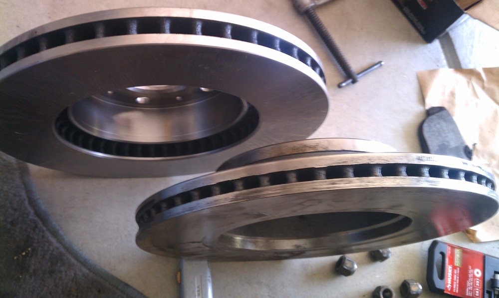

Let's just say there is a huge difference in quality. These aftermarket rotors were not the cheapies but the upgraded ones from O'Reilly Auto Parts. The quality was so poor that we took them back and opted for OEM Volvo. The casting quality was lousy, the rotor was thinner (you can see the vented area is smaller too) and it's completely missing the venting down by the rotor hat.
OEM stuff is not cheap, but there's a reason.

The after market ones are great if you're about to sell the car. :)

Plus the hub is painted
