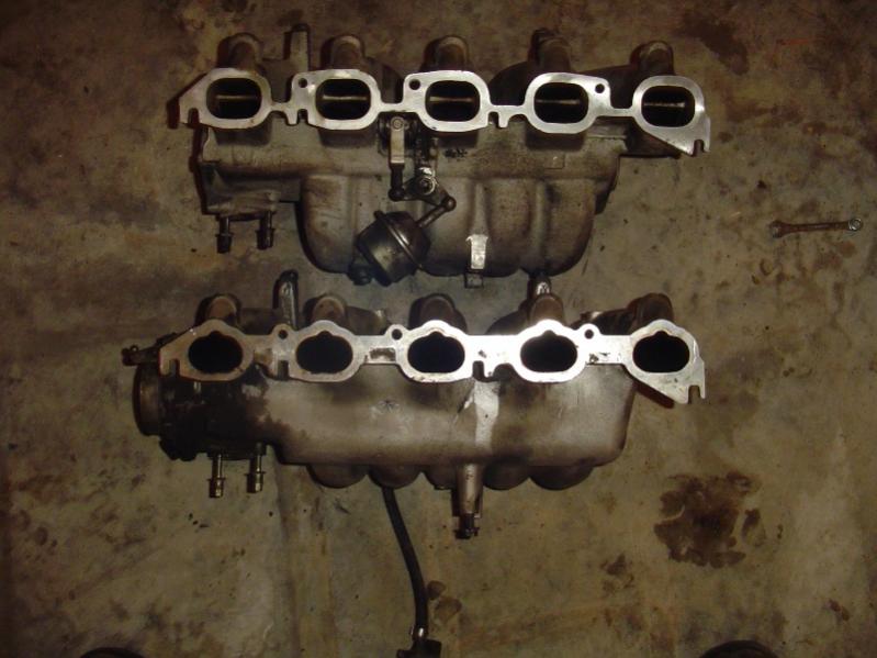

Ok, I found a comparison shot of our '93 VVIS intake. It is obviously the one on top. Evidently the guy I llinked in the last post came up with an electronic alternative to give control of the actuating valve. I want one.
I'm fairly sure that is what causes our flat spot.
