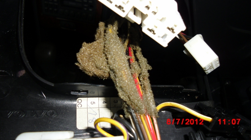

Here are some pictures that I took while checking out my center console. :oops: TreadQuarters didn't re-install it properly: carpet was sticking past the center console trim, piece broken off the wood grain, and auto shift knob indicator cover was loose. Never going back there again. They couldn't figure out how to properly adjust the e-brake after replacing the shoes!
Foam around wire bundles is disintegrating with age. Looking into wire wrap or zip ties to keep things organized.
