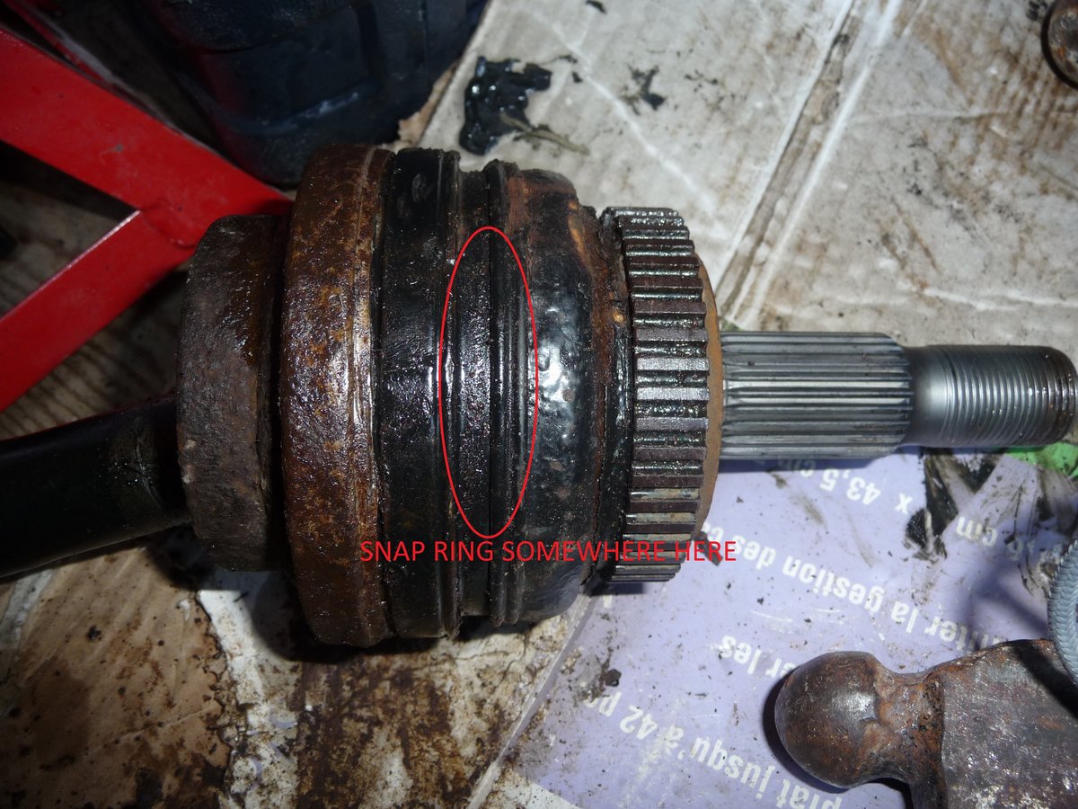

jimmy57, I'm trying to get this done today but I'm stuck at the snap ring. I cut the boot off and I'm sure the snap ring is on the end of the shaft inside the housing but how do you get at it?

Maybe, maybe not. Regardless, the axles are loose in the diff - they rock up and down a fair bit, the seals are gone and now I've cut the outer boot. I need to go ahead with the axle remove now but I'm not sure how to get into the housing where the snap ring resides.

Ok, got this job done finally. Inside the CV housing is a circlip, not a snap ring. Therefore, it is removed by a quick, firm pull. I found this out by accident because when I removed the axle the second time around I grabbed the end of the shaft instead of the middle and yanked - the shaft came out of the CV joint instead of the differential. Lucky, I guess.
In the end, my car is fully and permanently FWD now and drives much much smoother and quieter - no vibration and no noise.
