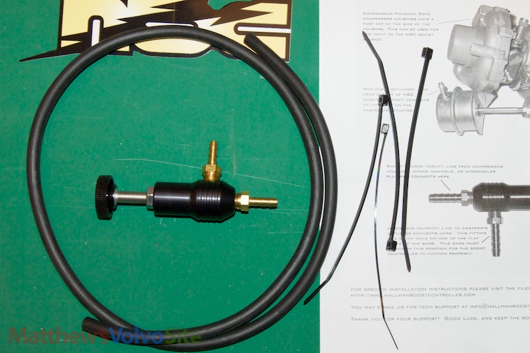

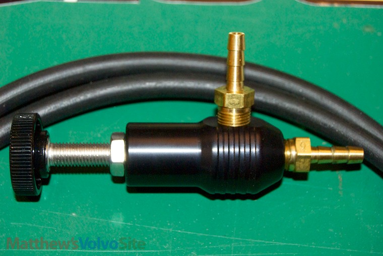

I've had a $80 Hallman ES MBC in my 850 T5 for months and it's great. Yes, you can make one for $20. If I could do it over, I'd go that route. It's just a dead-simple mechanical device that either works or doesn't. You'll know the second you accelerate from your driveway if you've gotten it terribly wrong. IF you have a boost gauge.
It boosts to 15psi in 2nd, 3rd, 4th gears, and up to 10psi in 1st. Stock T5 behavior is 10psi in any gear. I do not have an ECU remap/chip/tune. I do have an R ECU. I do not get fuel cutoff until ~90mph / full throttle.
I do have a boost gauge. I would feel very uneasy using an MBC without one.

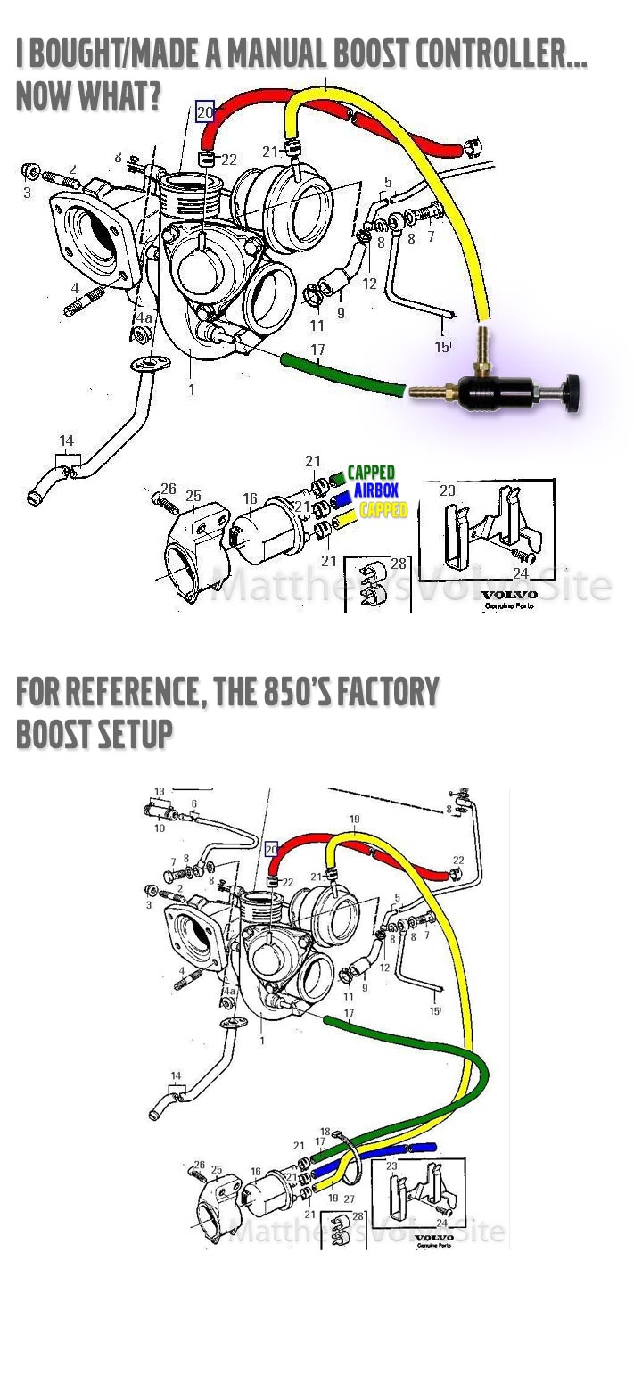

Hey Matthew!
If you have a moment, would you mind explaining where/ how you installed the MBC in your vehicle? Is it before the TCV or after, directly inline or did you use t-fittings to use both the MBC and the TCV, etc?
I have a '01 S60t 2.4 (no, I wish it was a R design, but sadly it is not) and have been searching high and low for info on how to utilize a MBC without building too much boost in the low gears. I have posted a diagram that someone shared with me at this link - www.matthewsvolvosite.com/forums/viewtopic.php?f=5&t=19645&p=248994#p248994 and would love to know how this compares to your configuration, or anyone else's who has had success with a MBC in a turbo Volvo.
Currently, with the configuration shown in the diagram (and I'll be glad to post it again if you would like, I just didn't want to over do it) I can't get over 9lbs of boost. This method works in conjunction with the IPD TCV, so the boost in the low gears is regulated by the TCV/ waste gate actuator arm (set @ 4.5 - 5#) but I'm wondering if there is constant bleed-off to the waste gate which won't let me get over 9#. Any help would be VERY much appreciated as I've been chasing this one for quite some time. Thanks!

Hello SS
Source for MBC: compressor housing (green)
Output of MBC: wastegate actuator (yellow)
I capped two of three TCV ports -- the same two (green and yellow in that chart, NOT as labeled on the TCV) that now have no job to do.

Matthew,
Thanks so much for taking the time to respond. Finally the mystery is solved. There are several (and likely many) others with the same questions and on several threads. Is there any way to combine so that all could see the above sought after answer? Would you like me to message you links to the threads I found? Just want to give back what you passed on to me. Thanks again.
Geoffrey
