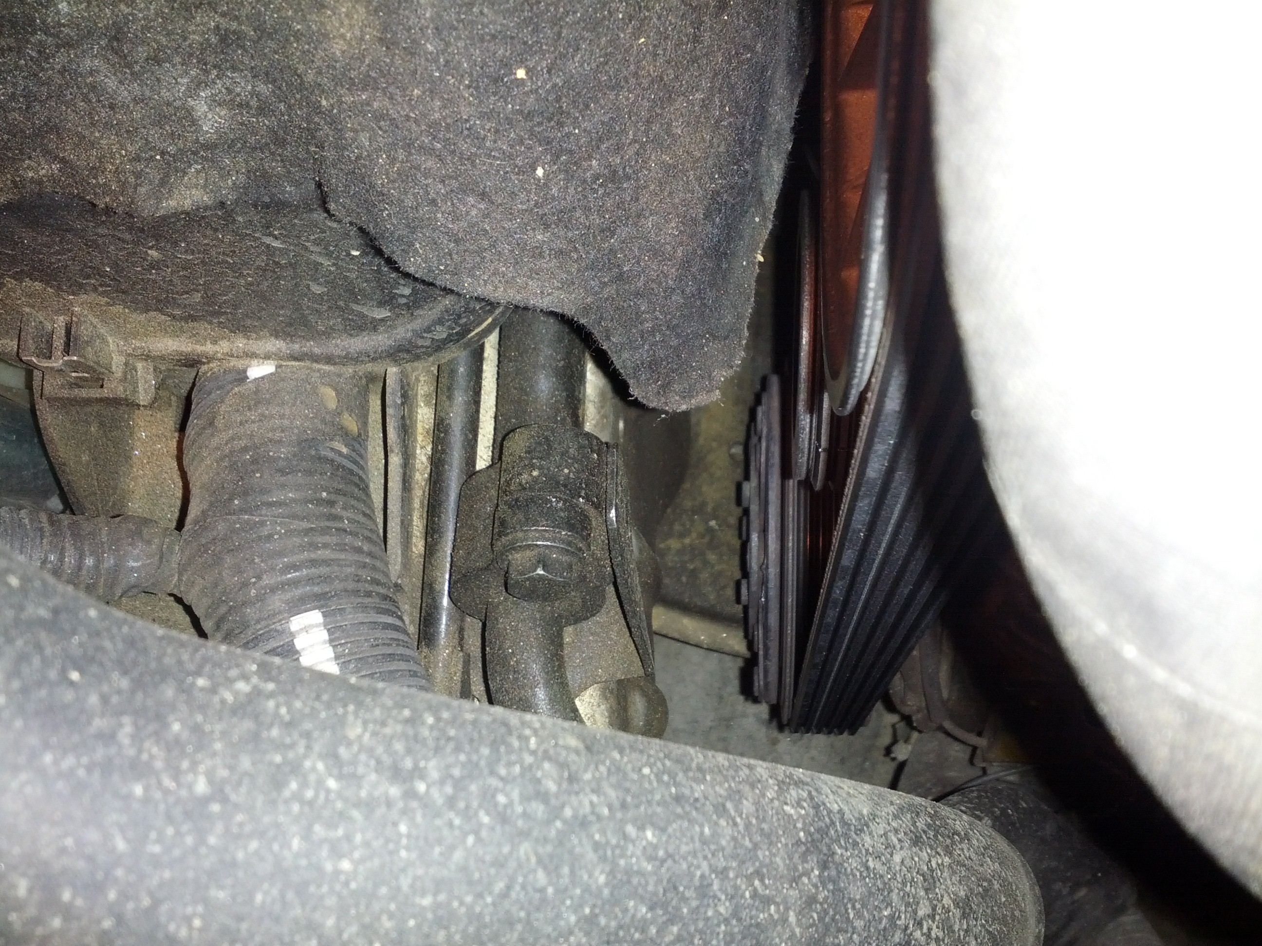

My latest: 6 zip ties as shown below.
You have to do it the trial-and error method because every car is different.
Make sure you have different assortments of zip tie sizes.
My AC Gap is now 0.35mm.
You can use a screw or screwdriver to wedge the thing open while you install the ziptie.
Make sure you remove the screw/screwdriver before firing up the engine!
Here are the locations of the 6 zip ties. First pic showed the black zip tie: Too Large, did not fit!
Then I went with the Smaller Grey zip tie, perfect!
