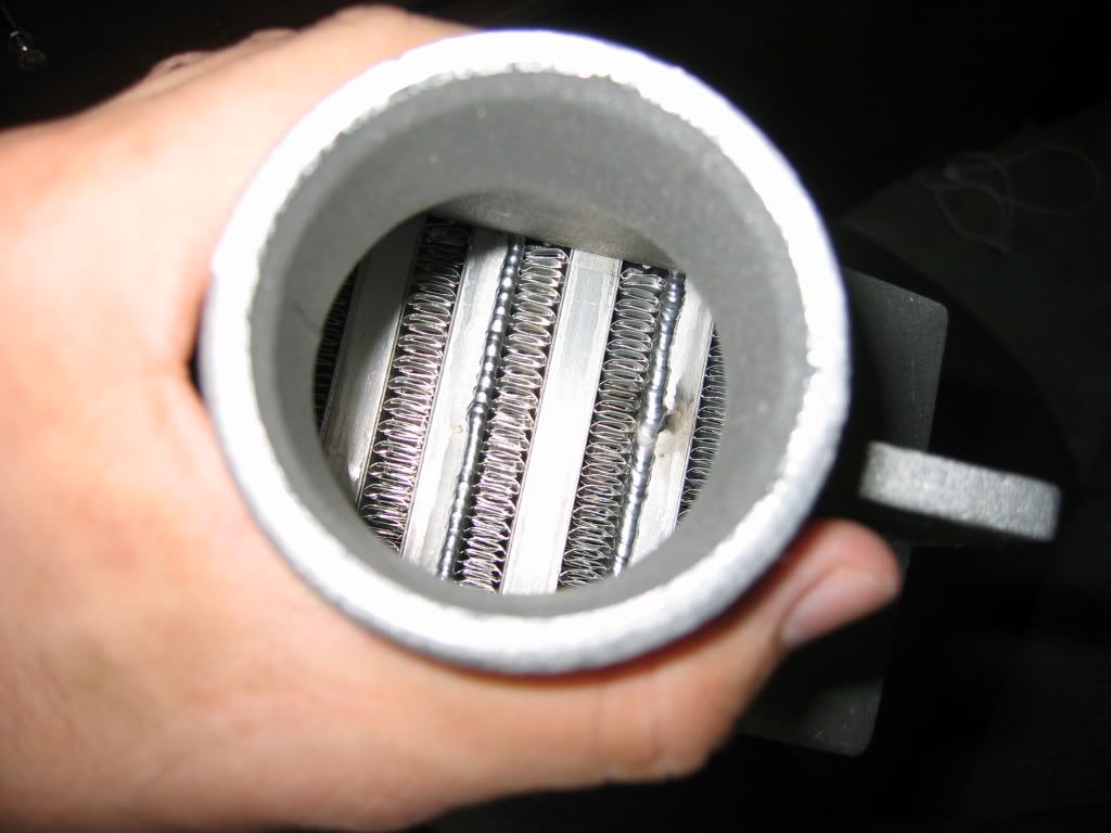

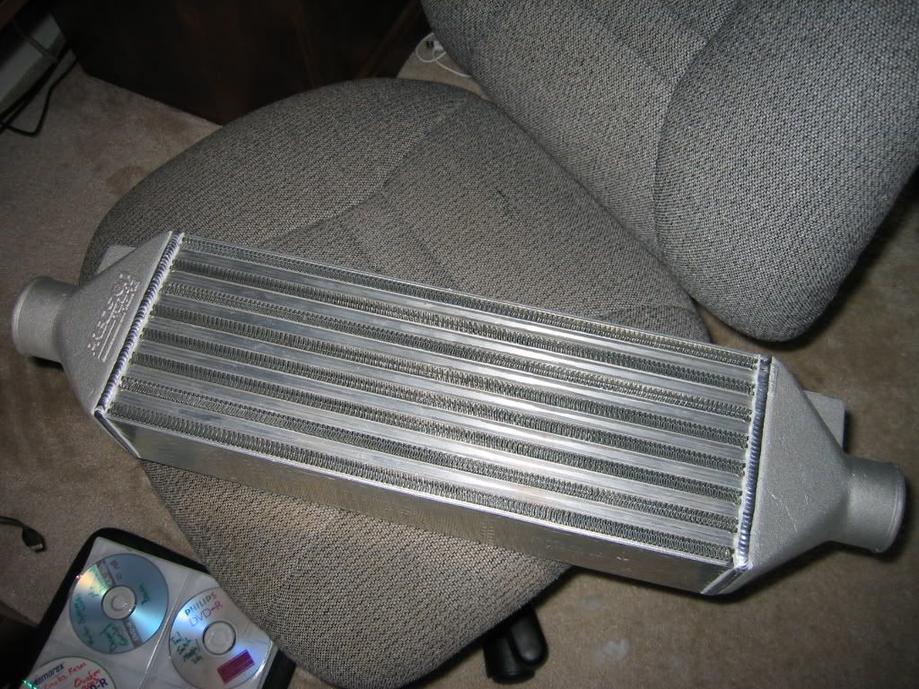

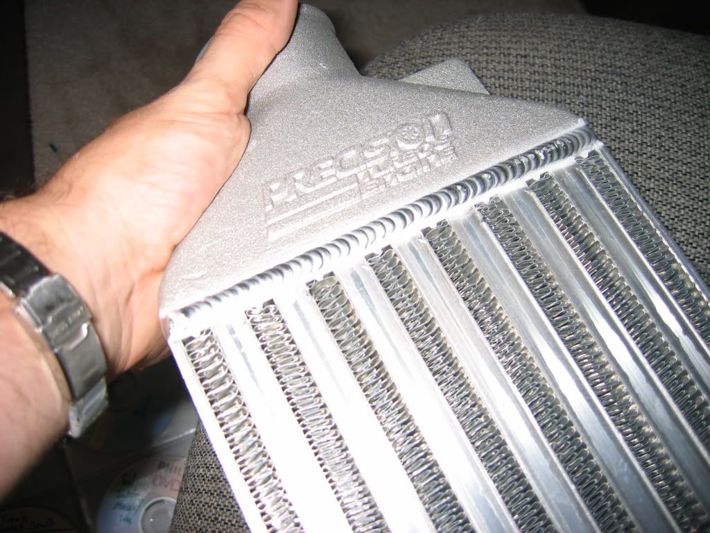

Monday I ordered a precision turbo FMIC
http://www.spoolinperformance.com/preci ... -p-65.html
And yesterday I talked to a local guy who supplies all the guys in town with intercooler piping. Reason I went went to him is because although the Ebay kits look affordable, I'd have to add several extra pieces at extra cost to get all the bends and sections needed.
I spoke with a few guys who have FMIC's installed on their S70's and have given me a fairly definitive parts list.
the piping, couplers, Tbolt clamps, reducers, etc totals $180 and no shipping since it's local.. ebay kits are like an extra $40 shipping. The IC was $230 with free shipping from nolimit so just a hair over $400 in parts.
I was close to getting a treadstone intercooler and while they claim to support more power for the money, the precsision IC's have a much higher quality from what I've been told and are better engineered. Besides, I don't plan on making over 350 whp any time soon anyways so this will do well... and when I do an engine build, the wife's T5 will get my IC setup.
I'm super stoked about this. Heatsoak is absolutely atrocious down here in Alabama. My car gets like an extra 20 hp it seems when it's cooler out. Piss poor factory IC flow and little to no actually cooling probably doesn't help either :roll:
Installation will go down MABEY this weekend if the IC gets here which hopefully it will. Gobs of pictures and instructions will also follow as I hope to put together some semi defnitive guide on everything needed and detailed instructions on install for all the 850 and pre 99 S/V 70 guys as I think everything is pretty much the same.
Also, hopefully a before and after dyno test will be done although I think the real performance measure will be on the road where air is blowing across it.

Anyways, lookie what showed up! 8) Piping guy called and said the pipes and all the misc connectors were delivered to the shop that we're installing it at so once I figure out when we have an evening this week or next free, install will go down.

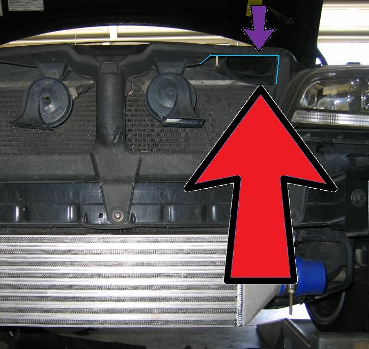

In the image you will see the two arrows at which I am referring to.
Where the air intake tube is (Red Arrow), there used to be a piece of plastic attached (Purple Arrow) which looked like to me it was there to stop water entering the airbox (Highlighted Blue)?
I see you have removed/cut yours off, have you had any problems with water entering the airbox?
.....*** I think it is called a snow-guard***.....

I removed mine and no problems what so ever... no water entering the airbox that is...
