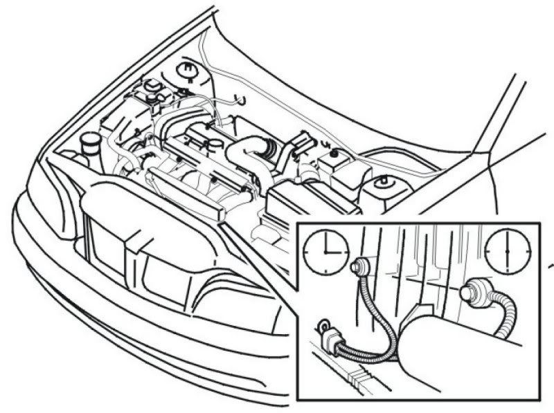

Changed my 2001 Volvo c70 convertible 2.3l turbo. Can these wires screw anywhere into the block. What is there purpose thanks.

Those are the knock sensors. They need to be where they were designed to be and torqued to spec. The sensors tell the ECM if there are any knock or detonation events occuring; if there are, the ECM will adjust timing to compensate.
16a in the image is just a different variant.

Found this so do they install just like this?

Yes. There's a screw hole on the engine under the intake manifold for each of them.
