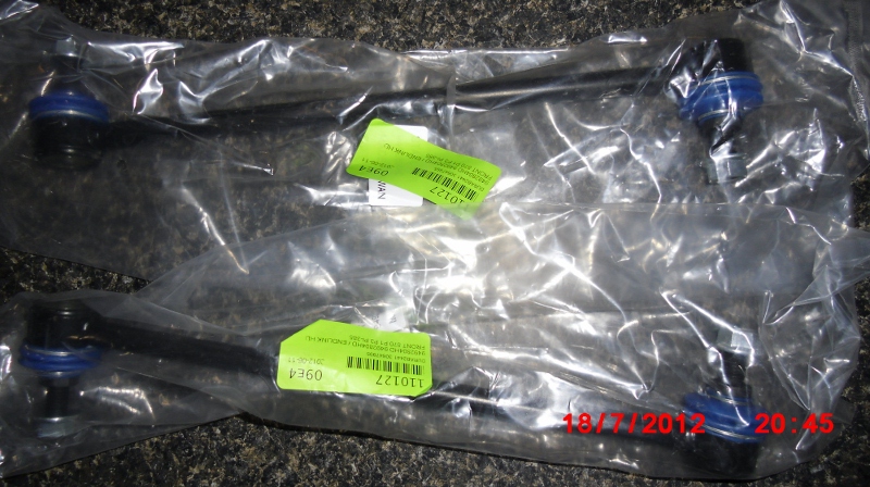

I think 45k miles out of endlinks is awesome, that's longer than the usual 3yr/36k new car warranty. My local shop is about to install iPd's endlinks in my 1998 V70 XC. Paperwork says they are Made in Taiwan, some Taiwanese manufacturers are world class and some are worse than the Chinese. But iPd's warranty and customer service is top notch. So I am not worried.
The roads here are in disrepair: holes, patches, dissimilar surfaces, uneven pavement, dips, bumps, etc... Thank God there's no road salt. I beat my car the last 5 years because it was a used car bargain. Can't tell if the parts were originals from the factory or replaced by the previous owner(s). Will update with my experience after a week or two of driving around, see if they're worth their reputation.
- iPd endlinks and Bilstein TC struts installed right 1998 V70 XC
- CIMG1895 (448x800).jpg (232.6 KiB) Viewed 2117 times
- iPd endlinks and Bilstein TC struts installed left 1998 V70 XC
- CIMG1894 (448x800).jpg (227.23 KiB) Viewed 2117 times
- Worn out OEM struts and endlinks off 1998 V70 XC
- CIMG1889 (448x800).jpg (219.91 KiB) Viewed 2117 times
- Bag fresh iPd endlinks, feels solid and looks good.
