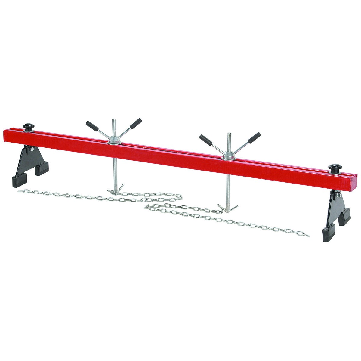

I need to do the rear main seal on mine when I get the opportunity and plan on doing it from the bottom. I don't have the facility, nor do I have an engine lift. ( I may be able to borrow a friends.) But either way I will probably pick up an engine support from Harbor Freight. It is inexpensive and should do the trick. Ive seen a write-up where someone was able to remove the complete subframe to replace bushings, and this little support bar did the trick.
If you plan on tearing the whole block down and you say you have an engine lift and stand, you might as well just take the engine and trans both through the top, and separate them after you pull them. As the previous post explained, the trans will not come apart while mounted in the car.
Good luck.
EDIT: I stand corrected by jimmy57 below, It sounds tight. Fun too.
http://www.harborfreight.com/1000-lb-ca ... 96524.html
Good luck.
- engine support bar.jpg (80.47 KiB) Viewed 2967 times
