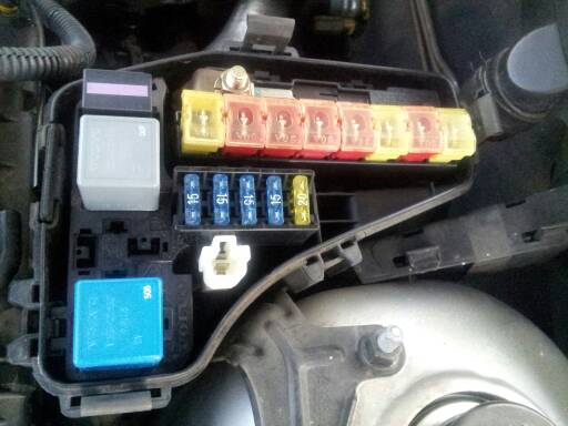

Check fuse #2 (second 15A fuse from the left) and engine management relay 9494448 (blue relay) in the engine compartment.
- uploadfromtaptalk1348967452647.jpg (29.01 KiB) Viewed 1701 times
