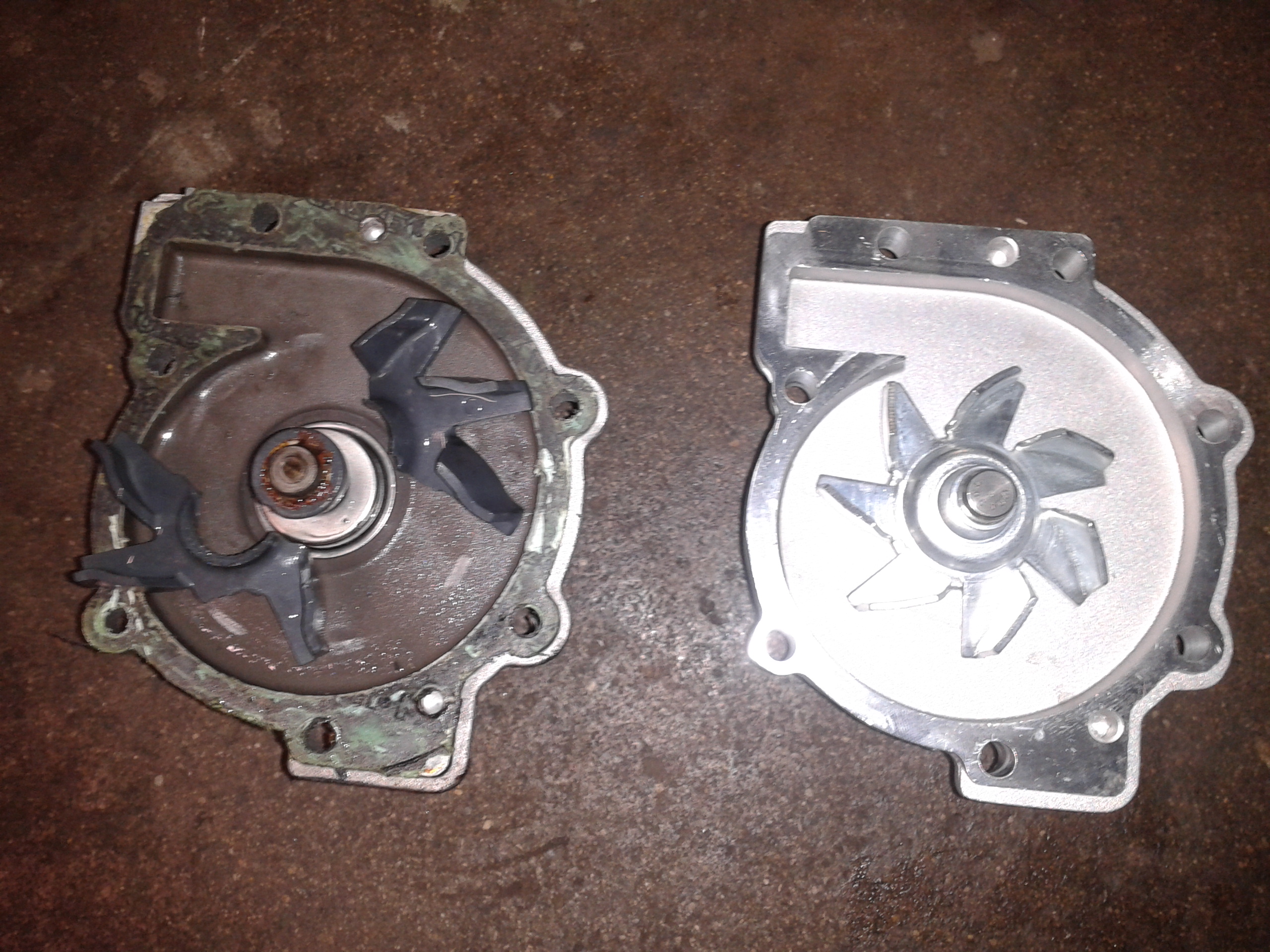

Guess what...

Broken Plastic Impeller!
Whatever you do, stick to Aisin or Hepu.
GM might be OK too.
