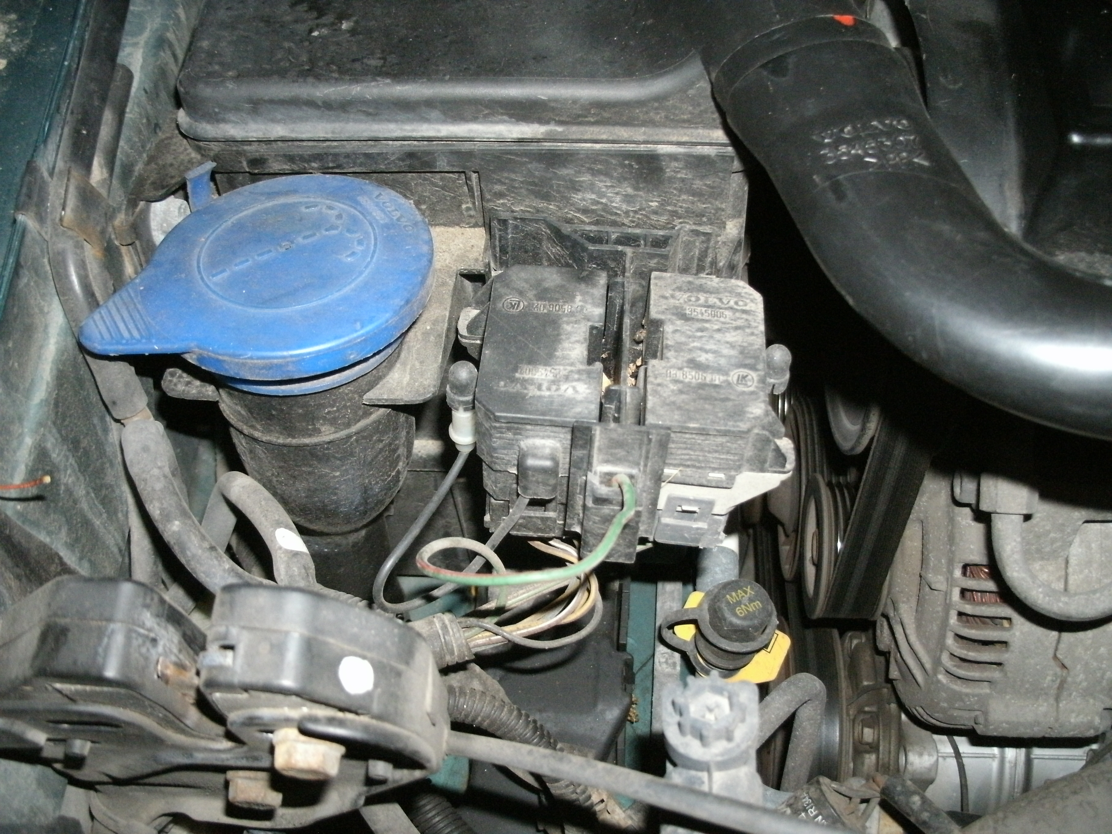

blackcomb1 wrote:none the wiser this end, fly wire (where is that located?) silly question maybe but I have never done this btw.
It comes out of the bottom of the A/B boxes, There is a hole on the cover where it should be plugged in to keep it from corroding.
...Lee

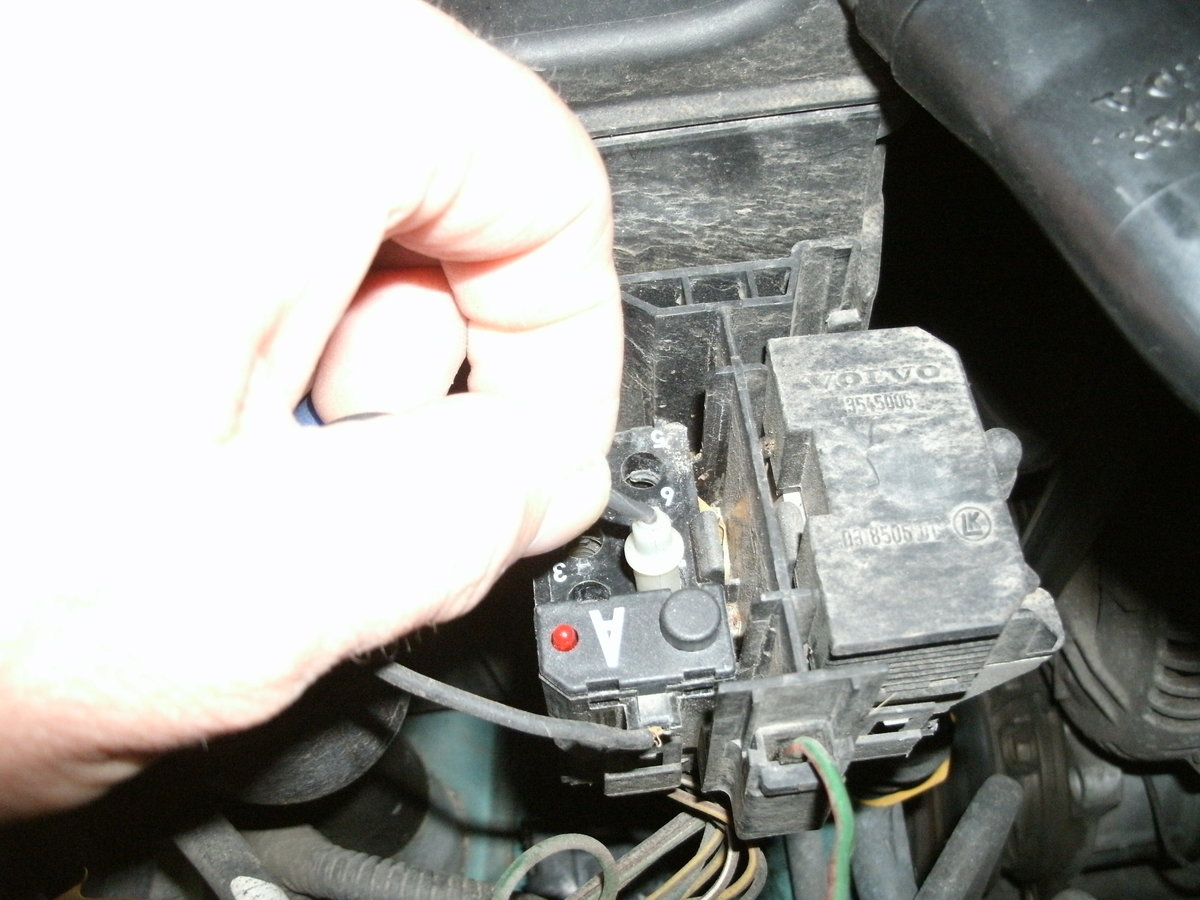

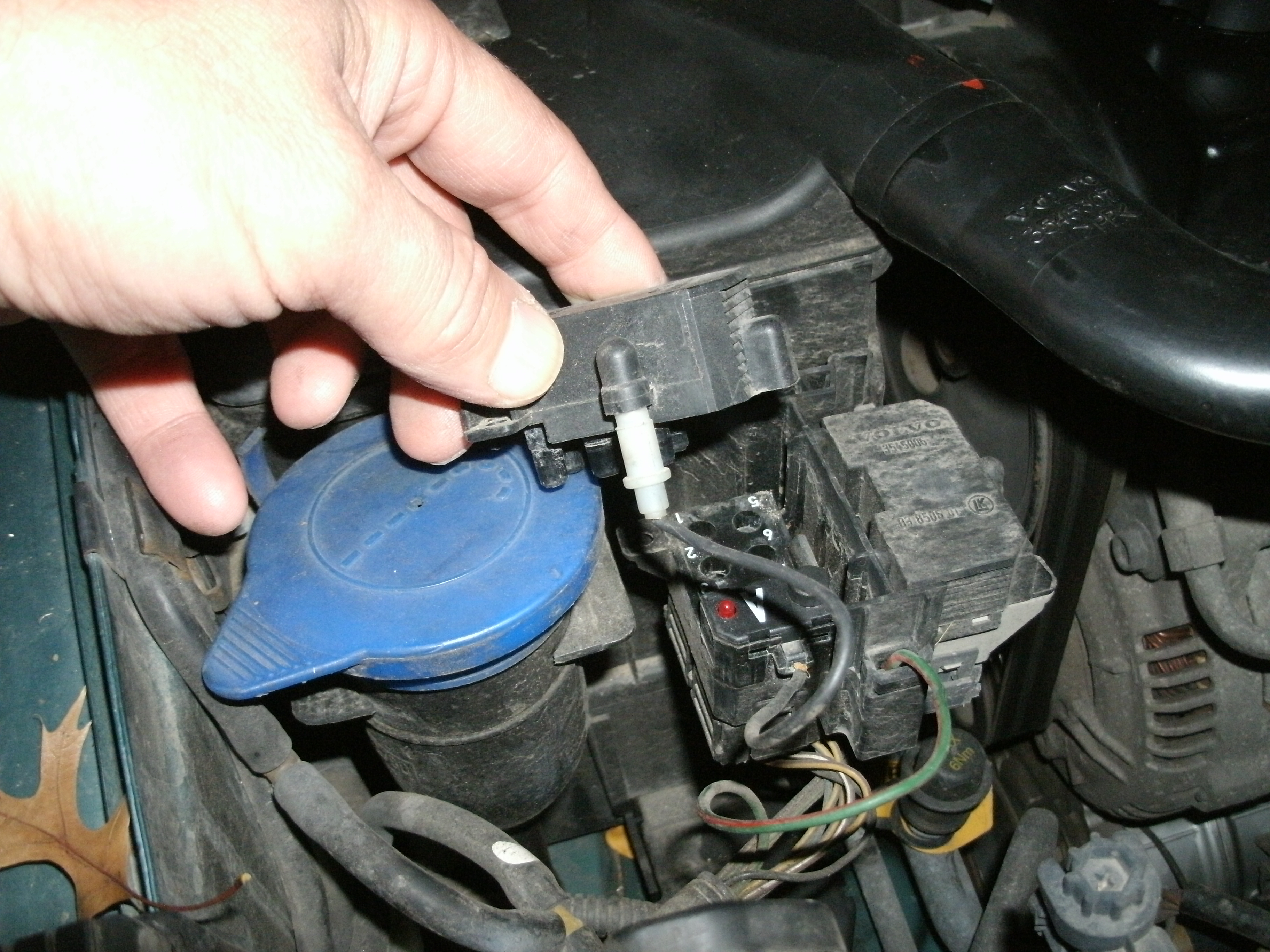

Ask and you shall receive.
The A/B diagnostic port boxes.
The flywire on side A.
The flywire plugged into port A-7.
You can also see the button next to the red LED.
