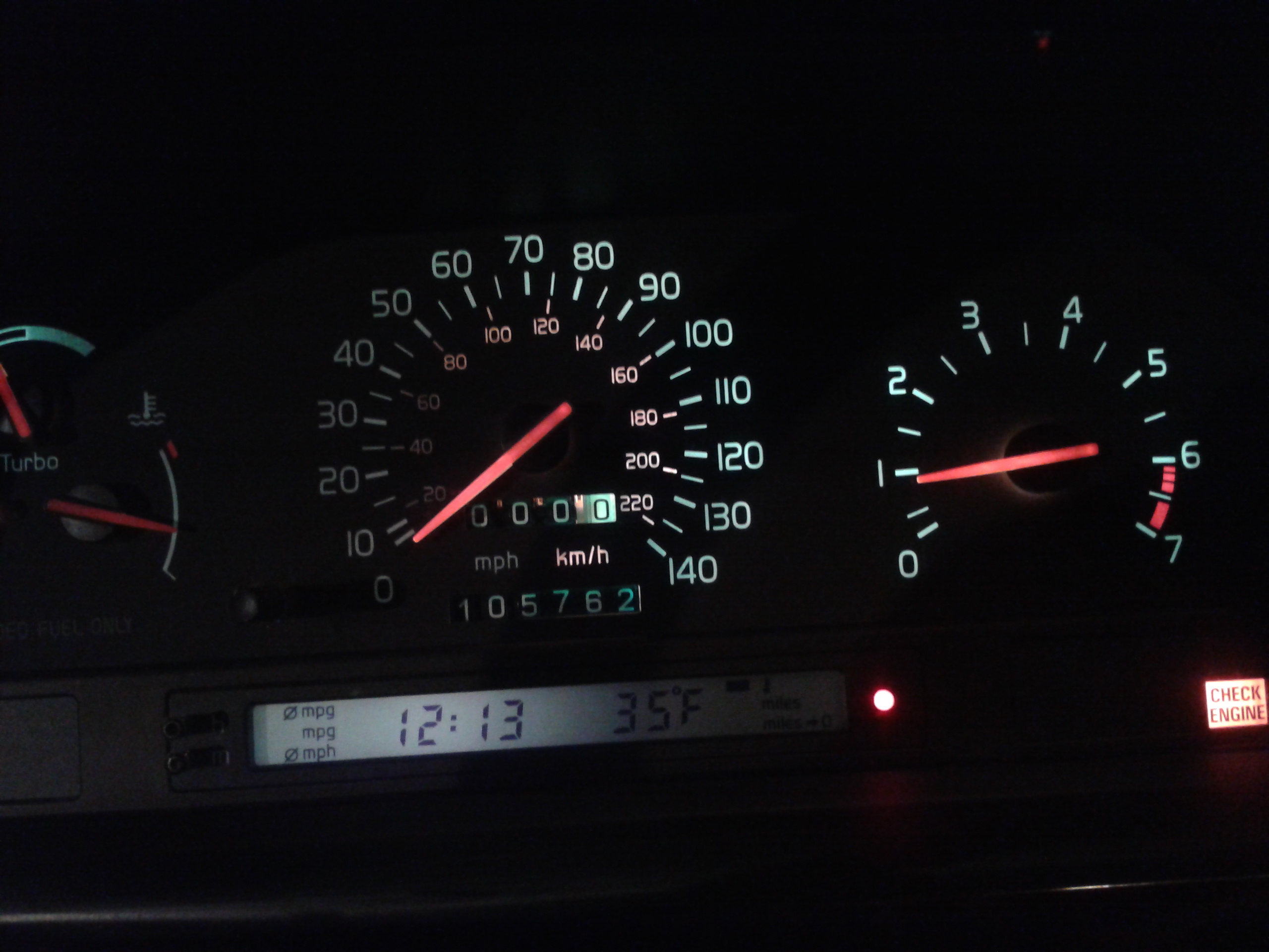

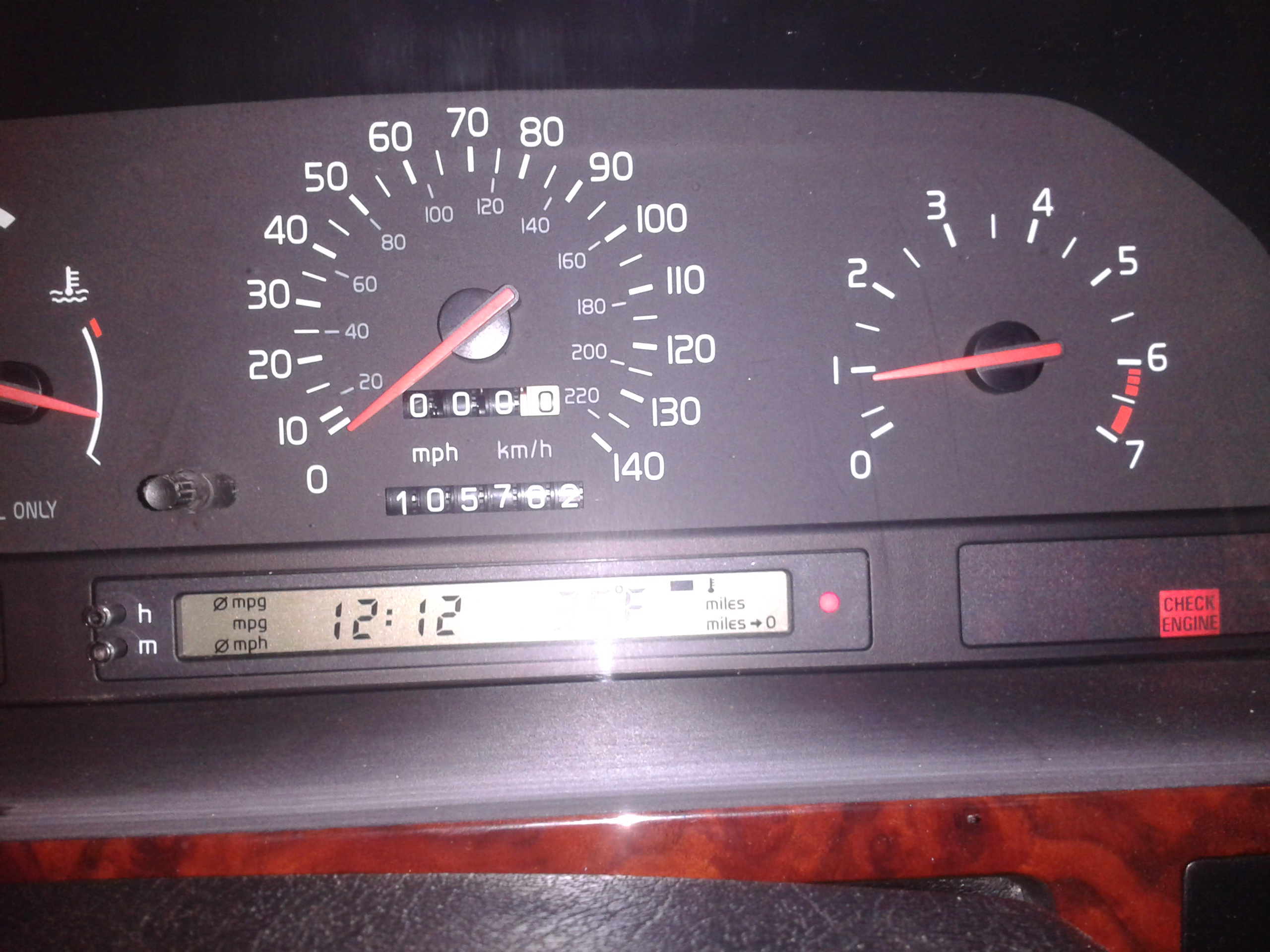

Hello everyone I am new to the site. I have a 1994 Volvo 850 Turbo. I have had it for about two months now. Since the weather is getting colder I have noticed that when I start driving the car (without a warm up) that a light in the dashboard will come on and the screen will switch from mpg (where I usually have it) to the temperature gauge. I have looked all over the website to see if anyone has previously posted this but I cannot find any threads. Does anyone know what this is?

Anytime it is 36 degrees or colder your display will automatically switch to the temp and light up the red light to alert you. You can change it back by turning the selector knob.

+1 It is meant alert you of the temperatures at which roads are most likely to become icy.

Sorry it took so long to reply. I am super busy all the time. I think you guys are right, after I read the first response I would check the thermometer on my phone and it was accurate. I was freaking out for nothing. I will check the codes and get the odometer fixed when I have money. First I need to replace the oil lines according to my bf. Thanks for all the help everyone!
