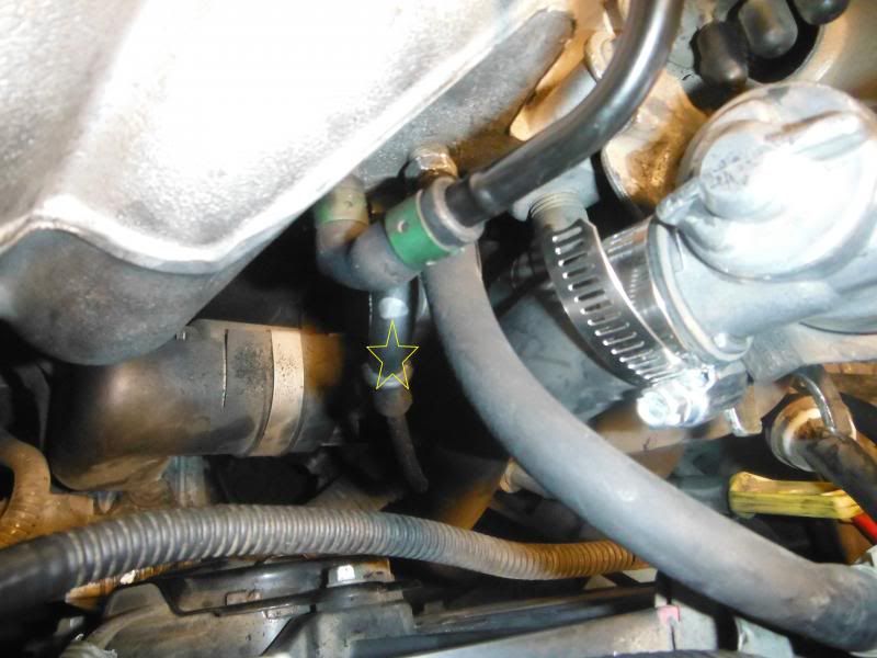

Could use some help with anyone with some input. I just did a PCV repair job and need help getting my vac lines back in the correct place. The problem is the diagram on my hood and in this forum do not seem to match reality. Take a look at the pictures below. The diagram where the red star is shows only two line there going into the manifold. One is the fuel return and the other comes off a check valve that goes to the purge valve. But where does the third one go to with the yellow star in the second picture?

What car are you asking about? Please add a model to your registration information in addition to the year of the car. Use the user control panel to add the information, that way we don't need to ask every time you post.
Where the line goes depends on what car you are working on and whether it is a turbo or not.
