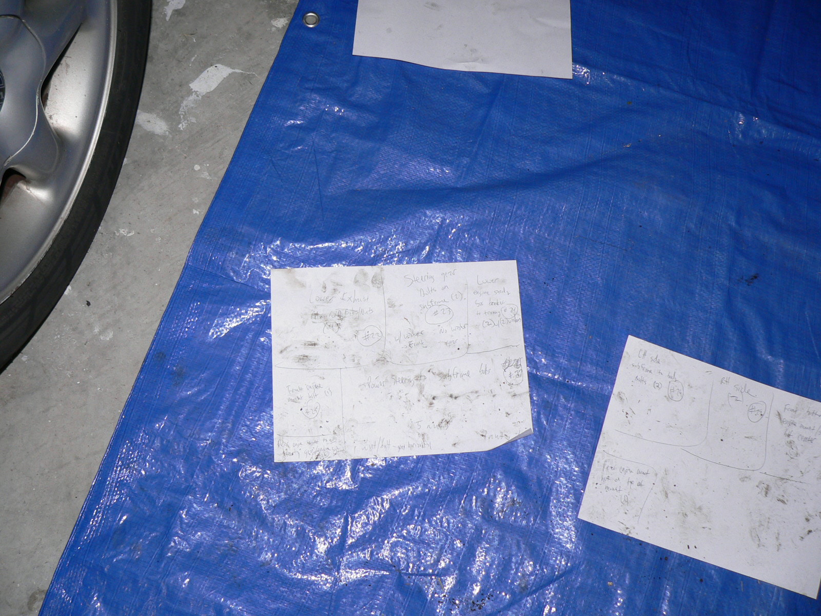

Some helpful hints:
  • Put a tarp down and orient the parts you take off from left to right, top to bottom, in sequential order.
  • Any bolts or odd parts you take off and must remove, place a sheet of paper down below and write on the paper what is there, how many are there, and the step # you are on in whatever guide you are following.
  • Any bolts/nuts that do NOT have to be taken off, put them back where they came. You can see I even went to the extreme and put the lug nuts back in to the hub.
  • Put your tools away at the end of each step to avoid losing any. If you are short, don't move on until you find them.
Here's an example of using paper to help you out:
