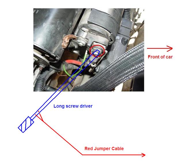

1. The starter motor option.
- Jack the front of the car up and and secure with jackstand (or place both front wheels on wood ramps).
- Crawl underneath and look upward, slightly to the left side is the starter motor (under the intake manifold).
- Get a flashlight and shine toward the starter motor, you will see the positive post (red circle).
- Use a long screw driver to touch that positive post and clamp the jumper red cable to the other side of the metal of the screw driver.
- Clamp the black jumper cable to the engine/chassis ground.
- Then ask someone else to connect the jumper cables to the donor battery (verify polarity!) and ask that person to operate the remote to open the door.

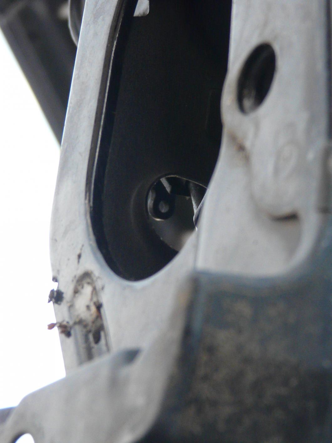

2. The turn signal light assembly method.
- Remove the LF turn signal assembly (pull it forward), search forum.
- Then kneel down and look upward, you should see the hole in the latch assembly, use a coat hanger or some wire to tug on it to open the hood.

Thanks for the quick reply - Looks like I will have to try method 1 - I am not sure that method 2 would work without getting the hood open... I called about the key and they quoted me around 50 dollars and it would have to be ordered... hmm
