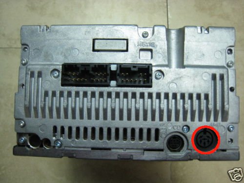

The only other things I'd check are the power right at the back of the radio
and the longshot possibility of this car having an external amp with a loose plug.
Both of these are easily checked without unplugging the radio.
Remember - IF YOU UNPLUG THE RADIO, YOU"LL NEED THE SECURITY CODE !
Pull the radio and see if there's a round plug at the bottom corner:
SC-816 rear amp callout.jpg (37.26 KiB) Viewed 2269 times
If it's there, be sure it's plugged in securely.
The power connections are violet/yellow on pin 13 for switched ( I suspect it's good )
and two Green/Browns on pins 4 & 12 for constant ( This is the one I'd look harder at ).
