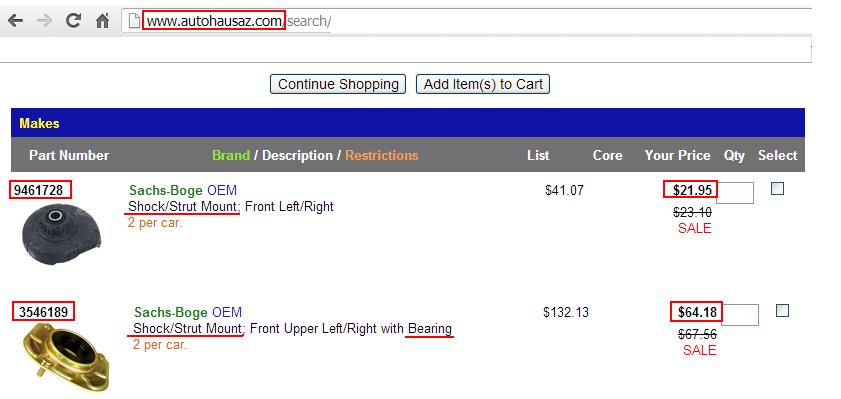

cordrayl,
Attached is a photo from autohausaz.com website, personally I think this brand (Sachs-Boge) is OEM, prices are good (free shipping if > $50) and you should replace these items anyway.
Do not fix this piecemeal because the labor will kill you.
The swaybar endlink is a piece of cake and can be done later.

1+,
cordrayl.....if one is a DIYer, then one can gamble and replaces only the "Seat", not the "Bearing" and goes back there later should the Bearing goes bad.
However, you are not a DIYer, so replace both of these.
Parts costs: ($21.95 + $64.18) x2 = $172.26.
Not a bad price for something you replace once every 14y/150K+ miles.
Replace them and enjoy the ride for the next 10y.
