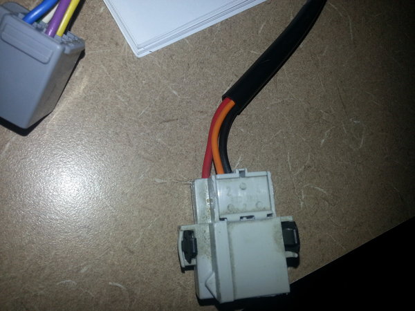

I did add the circuit breaker to the fuse box. I have twelve volts at the connector. there are three wires on the male connector from the seat:
green, black and orange. green is power ,black is ground , but not sure what the orange wire does. I'm sure in all these years I'm not the 1st to do this, but after searching the internet for hours, no seems to have posted about it doing it.

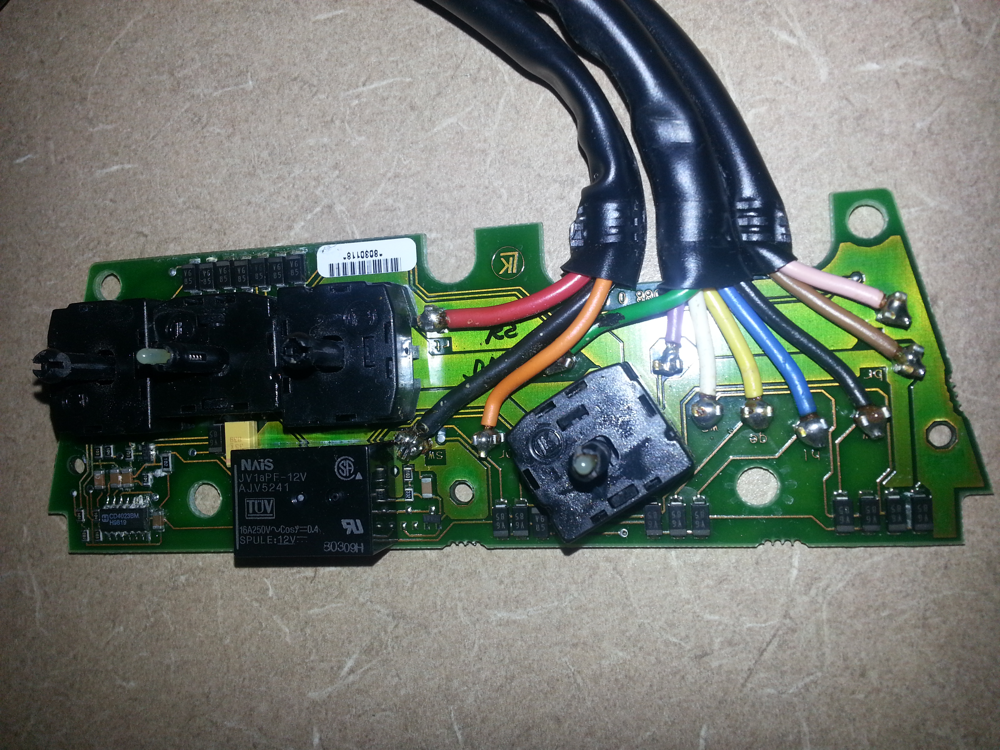

You should also get 12V on the Yellow/ Violet wire which is the third wire in the seat power connector coming from the car, this should only be live with the key in the position for power to the radio and ignition on, if its dead check Fuse 11C/35 (10A) The relay is on the PCB switch pack, it is the black box close to where the black wire is soldered to the PCB, you should be able to hear that click when you turn the ignition key on/ off, the only other relay involved

Result, F35 is used to switch the relay in the seat to deliver power to the switches and eventually the seat motors.
