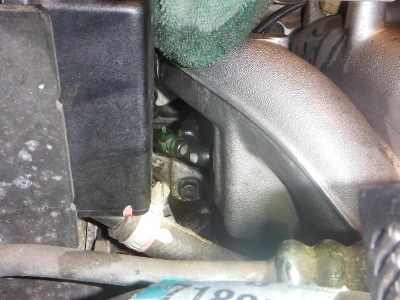

Hi My 99' V70 T5 is throwing both of the codes in this thread. I checked the elbow under the PS pump and thermostat and it looks connected and in good shape. There is however another insulated hose and elbow right next to it that is disconnected and I cannot figure out what it is supposed to connect to. See the picture below and see the hose with the green clip. Can anyone tell me where this is supposed to connect?

Post by erikv11 »
In your picture, the hose with the green clip is exactly the vacuum line that is the topic of this thread, the one everyone refers to as "the elbow behind the PS pump." That line connects to the PTC as discussed here, I would replace it with vacuum line as matthew1 describes.
