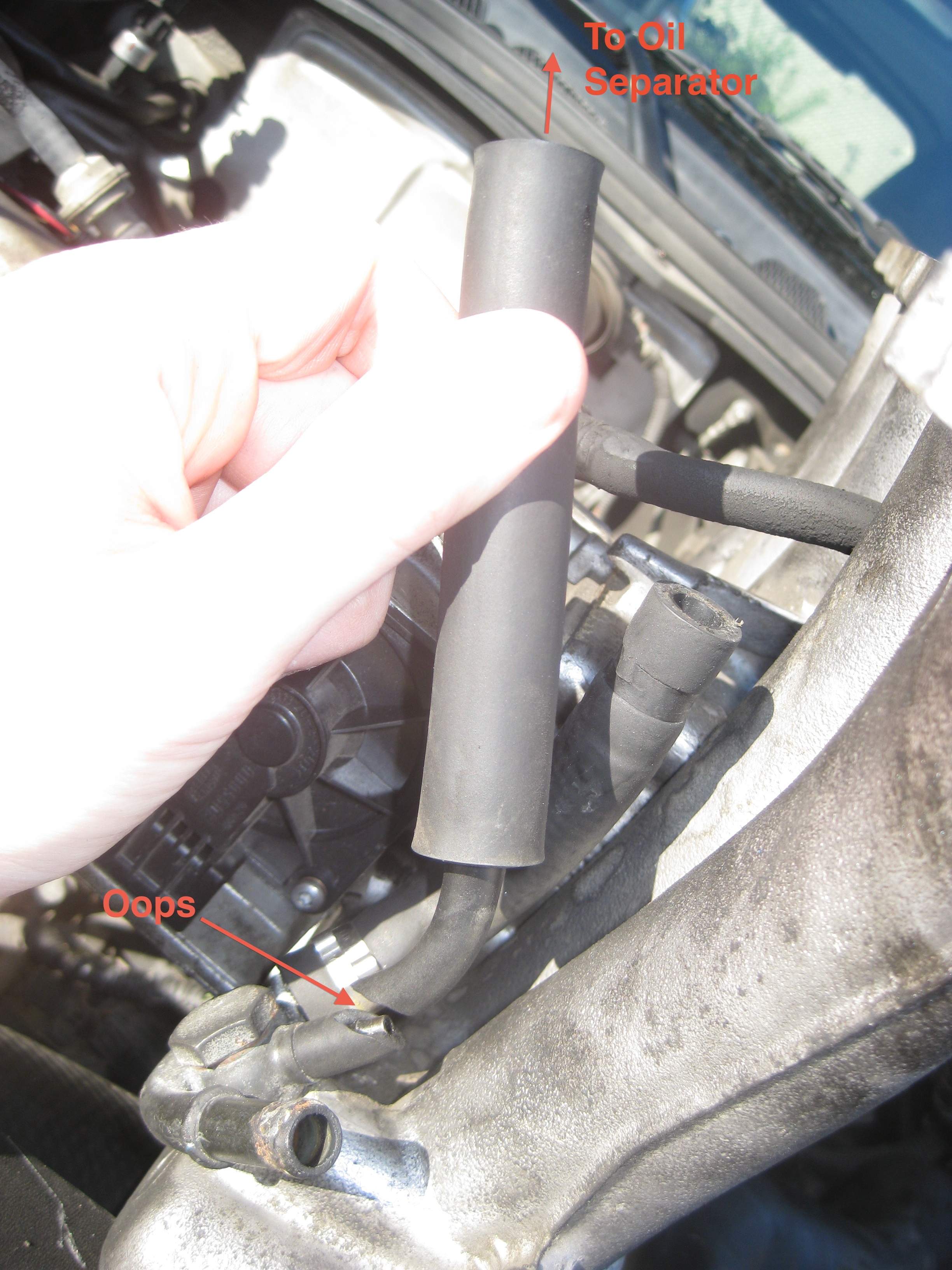

I broke the piece pictured. It goes from the Intake Manifold to the Oil Separator. I have two questions
1) How was I supposed to take it off (it just kind of snapped while I was moving around the manifold to disconnect some hoses)?
2) How do I replace it?
Thanks!

- Take the Banjo connection off (keep the washers for re-install).
This step is optional.
- Use some generic hose with correct diameter to repair it.

Ah, that does come off. It was stuck pretty tight. Thanks!

Wasn't that part in the new kit?

I had the same issue and replaced that hose with silicone.
