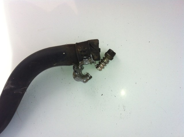

The vent line end was easily solved in classic style... I used a screwdriver blade from the underside to wrench the screw drive cover off the hose clip, destructively. 30 seconds and done.

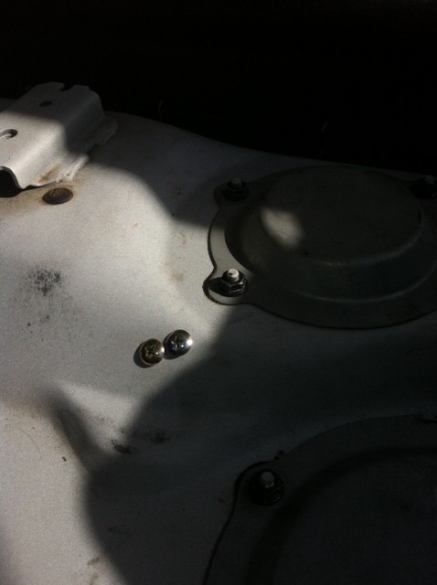

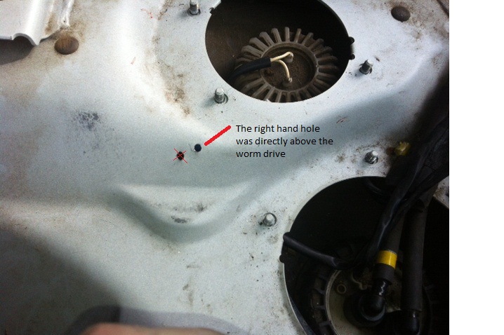

Instead I gingerly drilled a 1/8" diameter hole in the chassis just about the hose pipe... a photo will show my first attempt (a miss) and the second, which was ideal. Then it was a simple matter to unscrew the hose clamp, through the hole, and gently prise the pipe off.

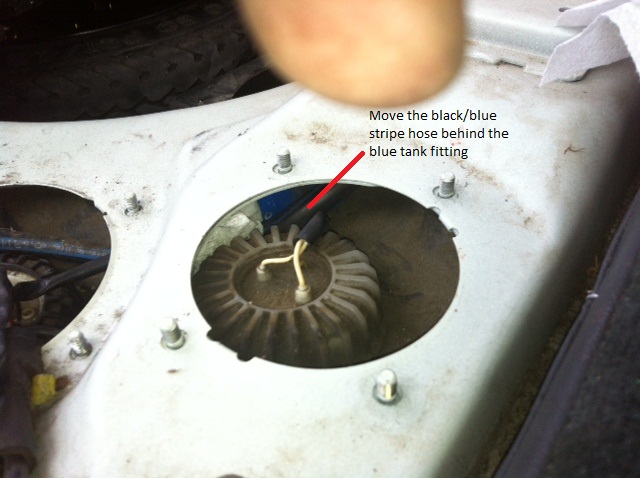

The tank end was a slight fiddle until I figured it. There is another black/blue striped hose in that space, plus the tank sensor wire. The trick is to push both these behind the blue connector or they will interfere with pushing the vent hose onto the fitting. Make sure the hose clamp is arranged so the tightening end is at the low side of the pipe, pointing out of the vent hole... simple to tighten, and one day to remove. To trim it out I found a couple of screws to tap into the chassis drill holes and restore that Swedish designed-in look.

Drill hole location
Drill hole location
drill hole location.jpg (101.37 KiB) Viewed 6390 times
Pipe location
Pipe location
pipe location.jpg (87.16 KiB) Viewed 6390 times
Vent end removal
Vent end removal
vent end removal.jpg (55.94 KiB) Viewed 6390 times
