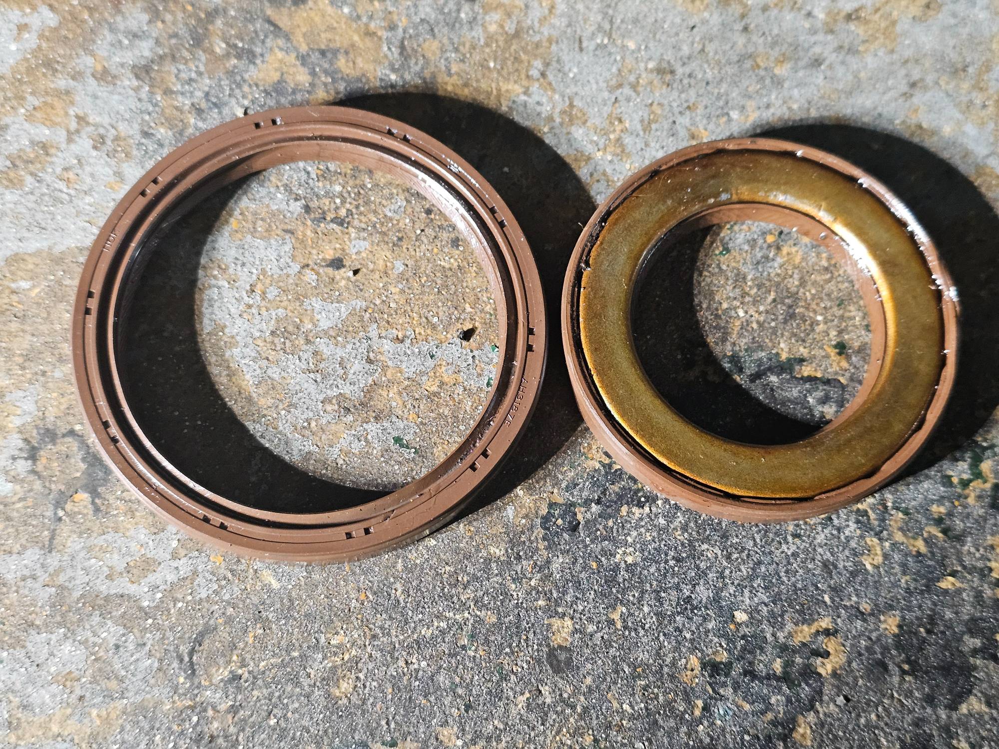

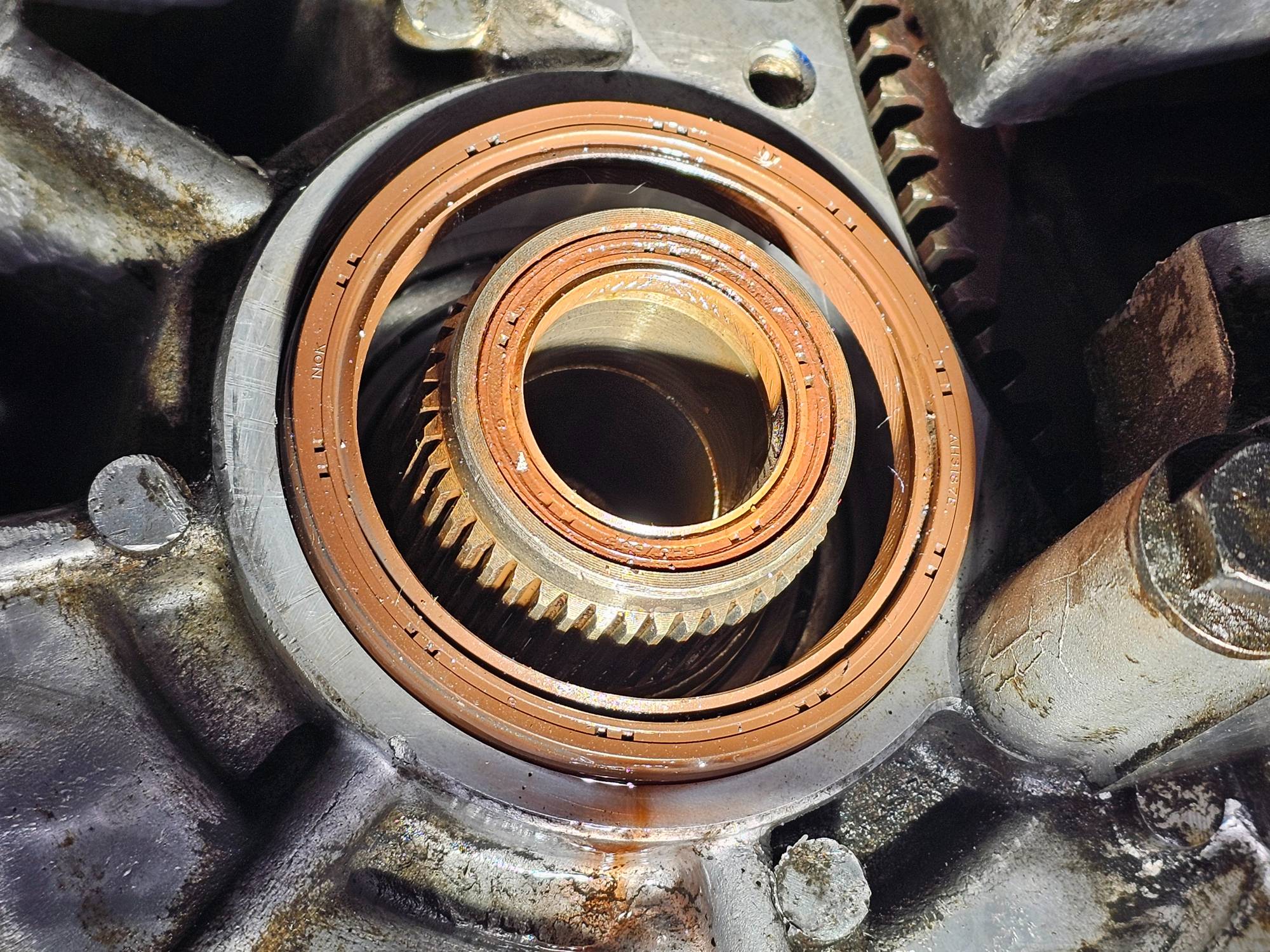

Alas, the seal for the FWD is not the correct seal needed to allow me to run a FWD passenger CV axle without the need to have bevel gear collar to prevent leakage of ATF. Am I missing something? Looking at the transmission again now, and the seal that the collar rides in has a good deal larger OD. and the seal wouldn't be sealing against the cv axle anyway, it would have to be sealing against the splines on the trans output that the cv shaft passes through... Or is this output actually to be removed? If anyone can shed some light here it'd be very much appreciated.

Trans output with current AWD seal.
Trans output splines.

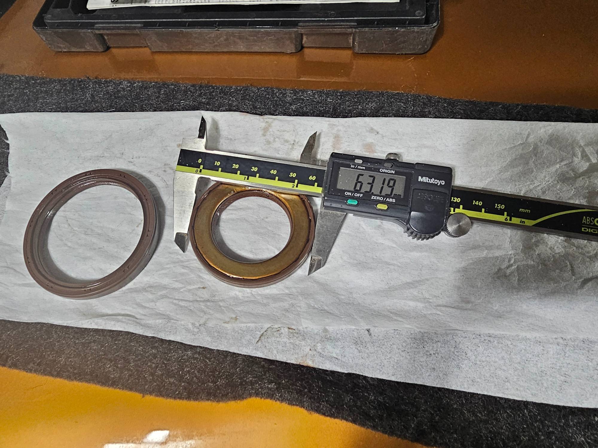

AWD trans seal on left, FWD trans seal on right (used one just for purpose of comparison)

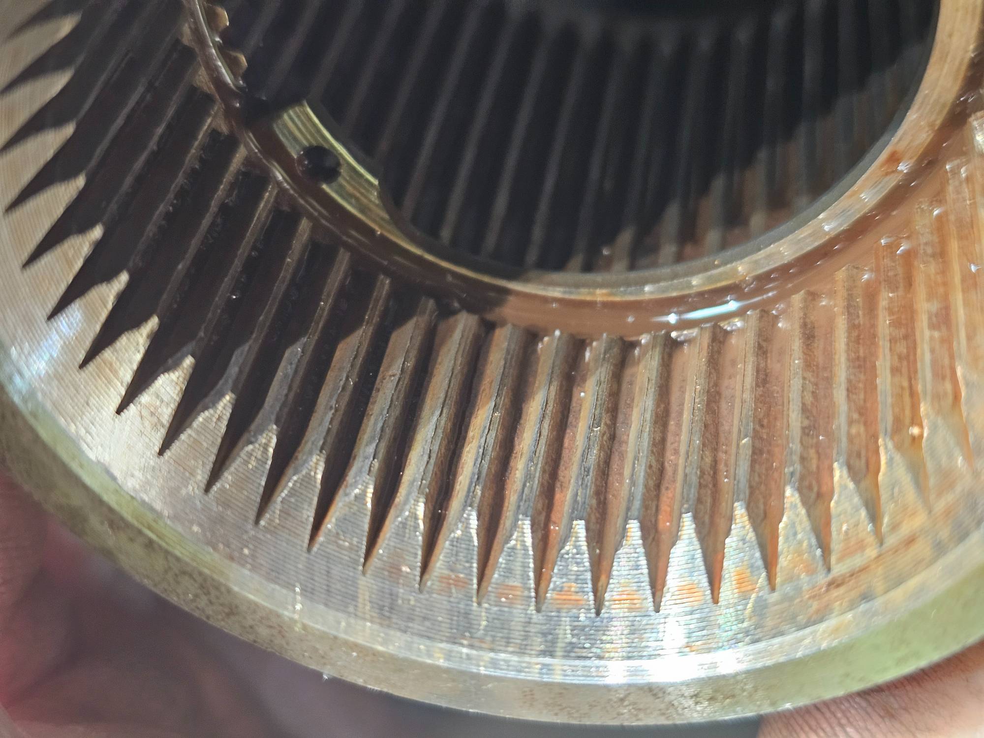

After reinstalling the bevel gear and the problem noise occurring more frequently, it looks like more wear than I saw initially, especially on the bevel gear side. What's the verdict, is the collar still useable, or has it done it's job and this is enough wear to cause my problem...?
Splines on the bevel gear side of collar.

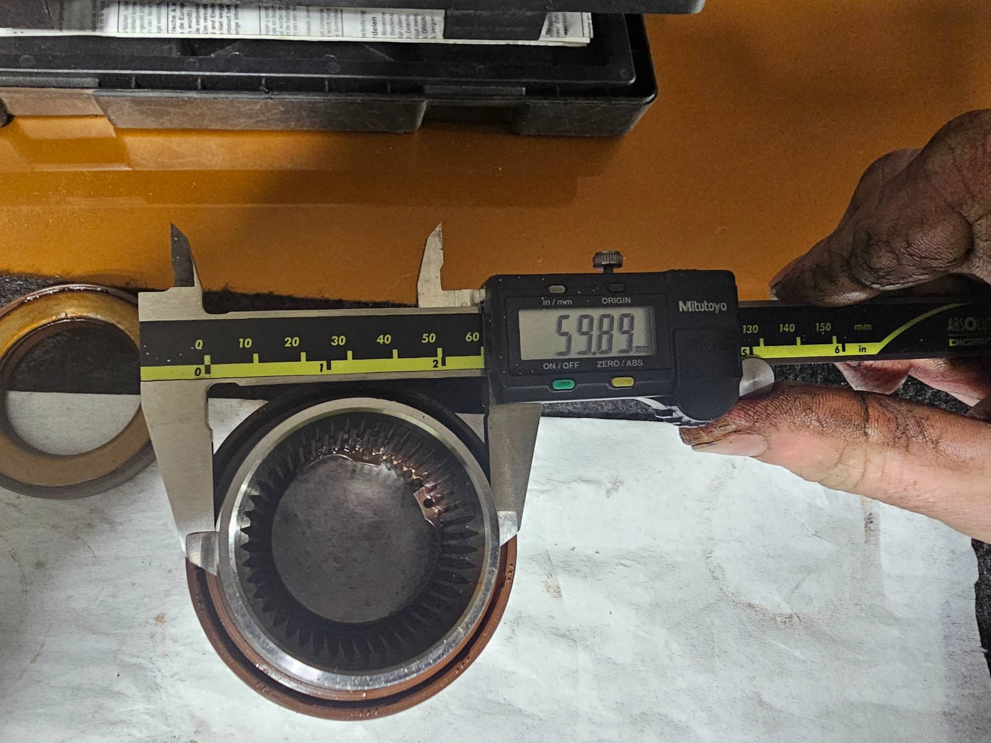

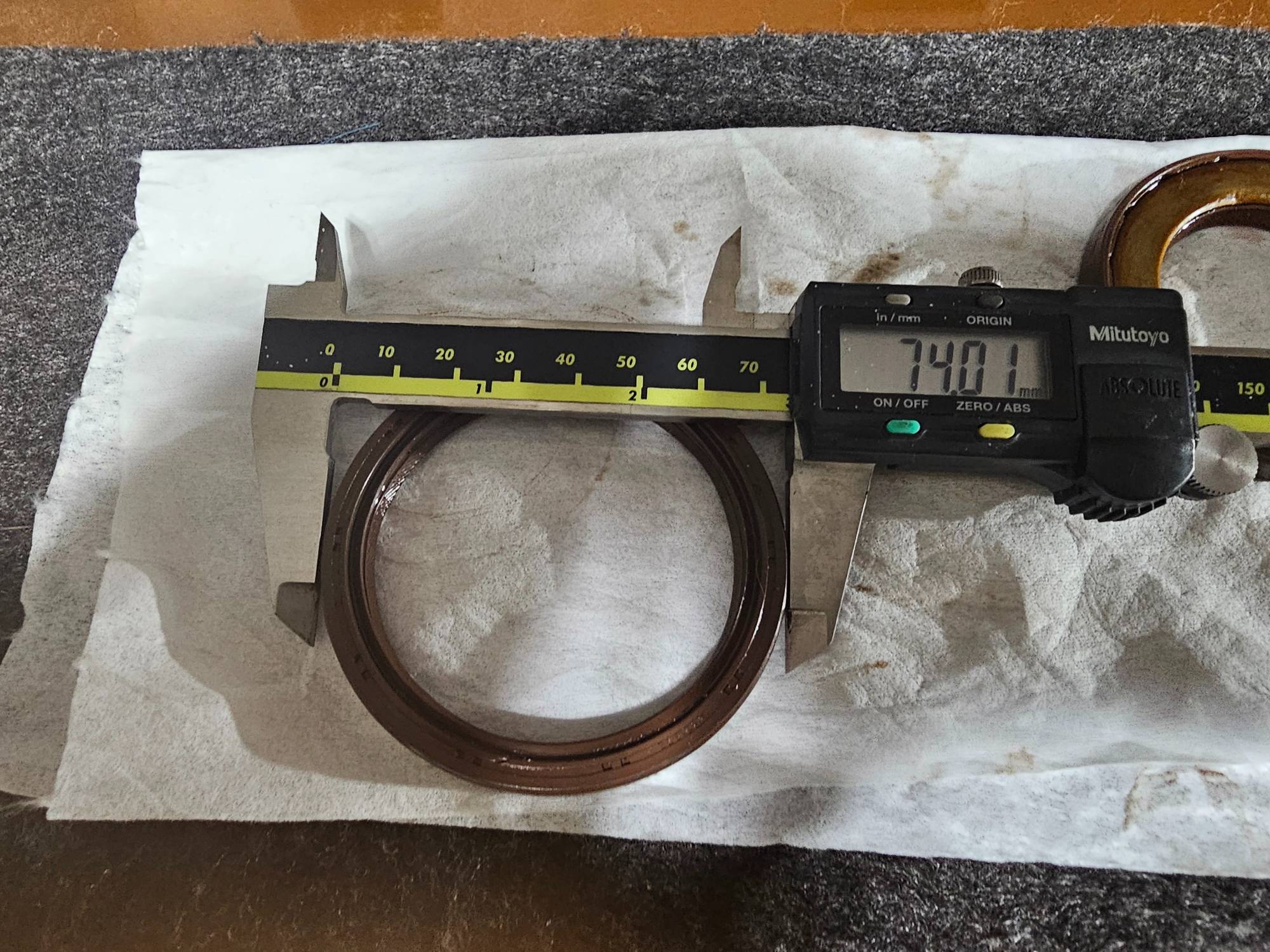

Measurements for seals (both 8.5mm thick):
Again, any help greatly appreciated!
