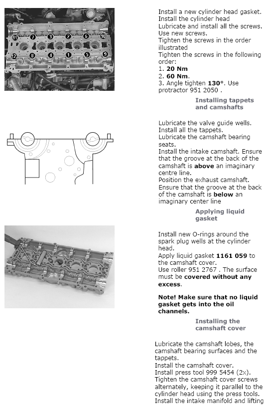

Hey! I changed my car's head gasket and I wanted to know, how is the correct way to install the exhaust camshaft? Thanks!

Post by fn42 »
VIDA instructions

At any time during the process, did you separate the cam sprockets from the cam shafts?
