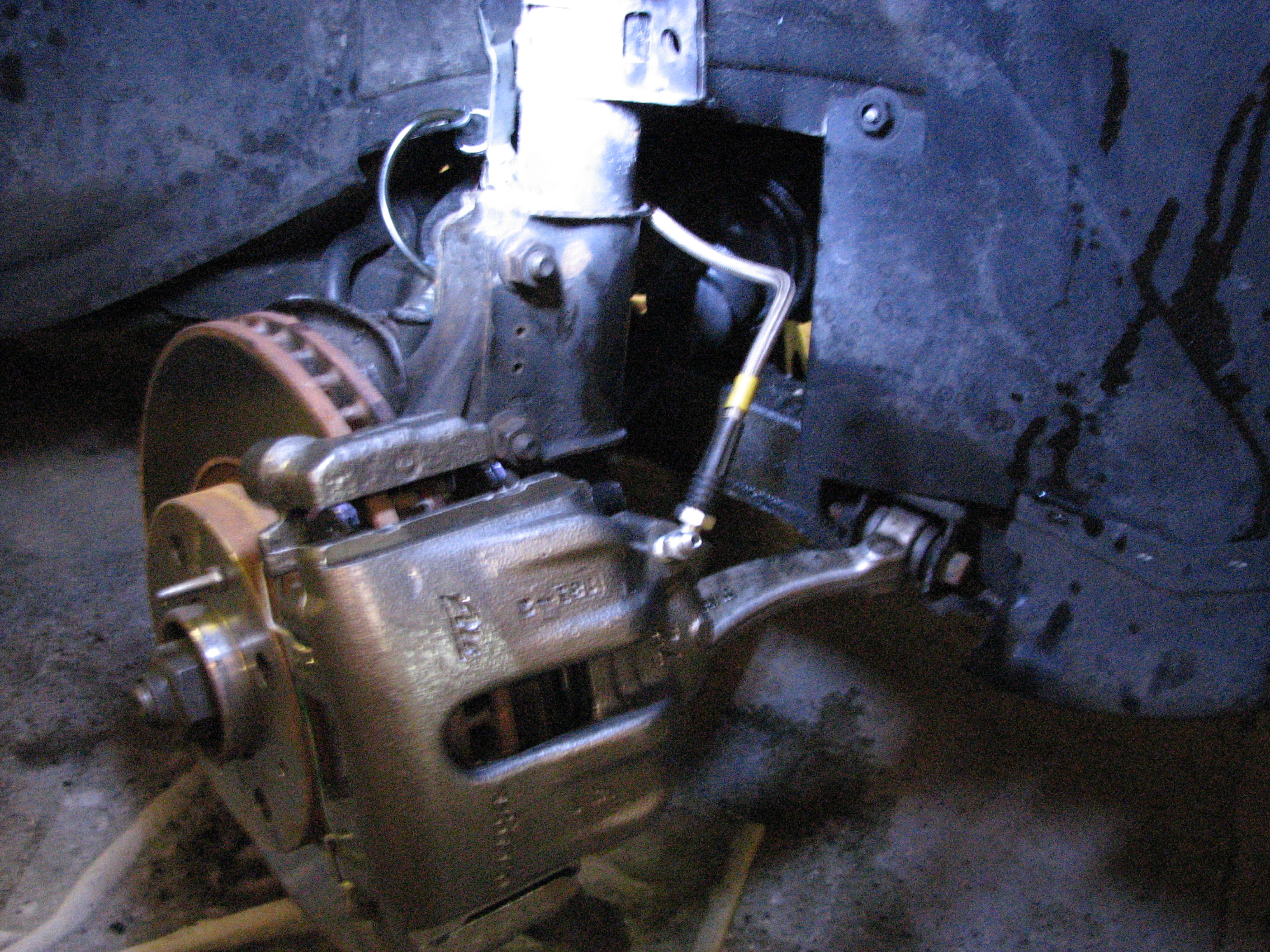

I replaced the front caliper lines with braided stainless. For rotors, just OEM style Brembos, and Akebono ceramic pads.
It is a noticeable improvement. I'm fairly sure your brakes feel soft like mine did before.
On a side note, I did replace the calipers with rebuilt OEM. Ofcourse bled enough out to make sure all fluid was all fresh.
