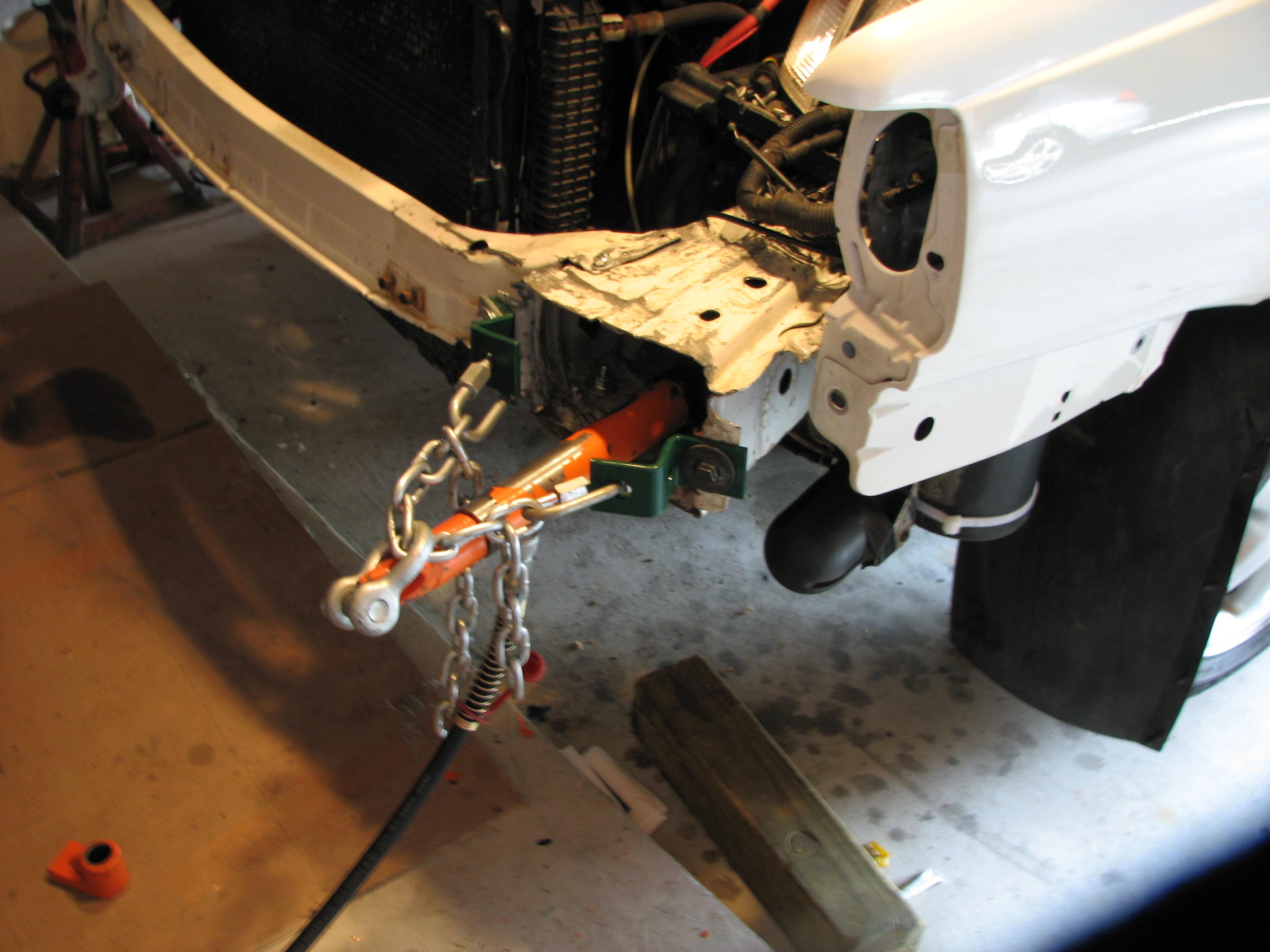

So progress has been quite slow on getting Big Red back on the road (weather, business travel, laziness, etc.), but we’re quite close. Dr. Brutal is concerned about the subframe having gotten bent in the accident, causing alignment problems.
From the (poor cell phone) image, you can see the bottom of the frame and a slight ‘wave’ in the metal running across the hole in the bottom of the frame - it should be a perfect circle. When he was inside the wheel well, he pulled the control arm off. The rear bolt was actually curved because of the impact. It was slight but enough to cause a challenge in getting the bolt out. I’ve not spent a tremendous amount of time inspecting the subframe for more damage, but I’m hoping I can just replace the bolt that was bent and be on my way.
My concern is that it may be unnecessary to swap the subframe. I have one on the parts car so it’s not a problem getting one, but I’d like to avoid the time & effort involved with getting an engine lift – actually two lifts, right? – and swap the frame and all the little bits involved. So I guess the bottom-line question is this; if there’s any damage to the subframe, no matter how slight, should it be replaced?
