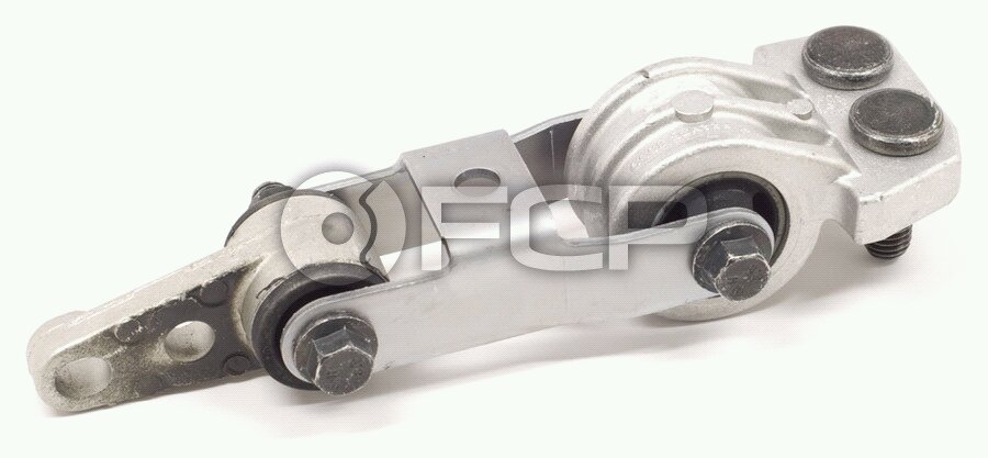

There is a small torque control mount going to the gearbox from the front crossmember (bottom photo)

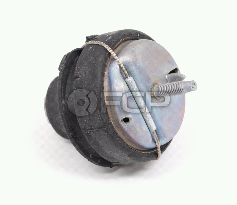

Also a large round hydraulic mount very close to it. There are 2 of these more or less opposite each other. The other one is on the exhaust side

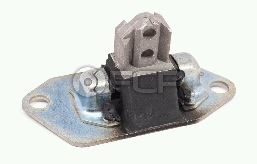

Also at the timing end of the engine you have a unique and rather large mount (first pic)

You will need to have someone rev the engine while you poke around under it to see what's loose. That front hydraulic mount would be the first one to view. The nuts are 15mm from memory. If you remove the 2 bolts on the front torque mount at the crossmember and also those at the timing end as well as removing the crossbrace across the strut towers you can try to then jack the engine up at the sump by using a pine brace to spread the load.
The most fiddly one is the rear hydraulic mount to fit but it may be ok.

If the hydraulic mounts have no visible leaks they would most likely be fine. It is the top engine mount, the transmission mount, and the lower front engine mount (at the belt side) that fail first usually.
