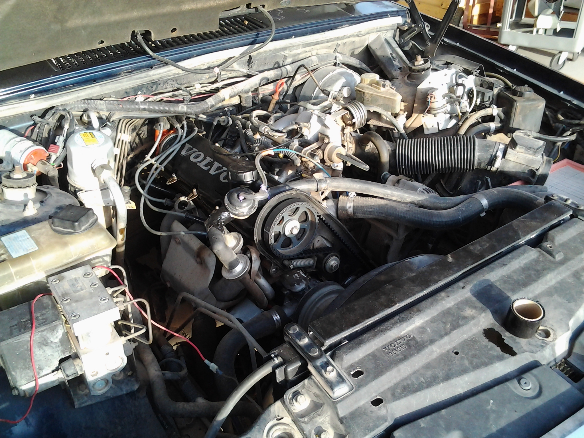

Here's a pic of the engine. It's the hose just behind the timing belt cover that goes over the valve cover. I broke the hose where it separates at the T above the exhaust manifold. I haven't seen it shown on any vacuum or emissions diagram I've seen. I taped it temporarily. I also noticed quite a puff out of the valve cover when the engine is running. Is that normal. I never noticed it before. One thing more to mention. Even though I haven't got a CEL I have checked the codes and they are normal.. I'm at a loss..
Continuing my research I found that stuff is pulse air system. Some of those parts are no longer available so it must not be too important. I think I'll just take it off... I've got the vacuum line to the valve plugged . Didn't change anything.. Hoping I get an error code.

You are ok to disconnect the pulse air system, usually it would leak exhaust gas from the valves. I have removed the valves and blanked them with small coins.
