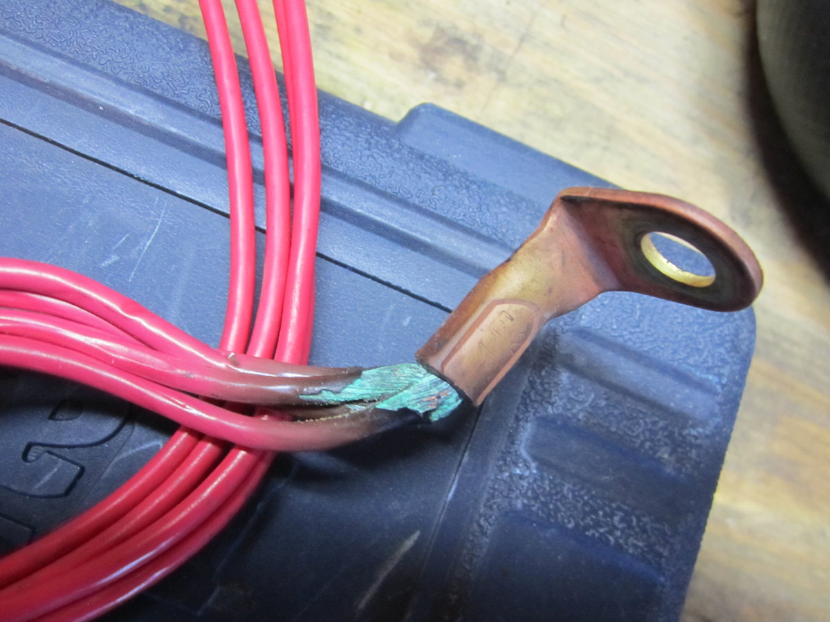

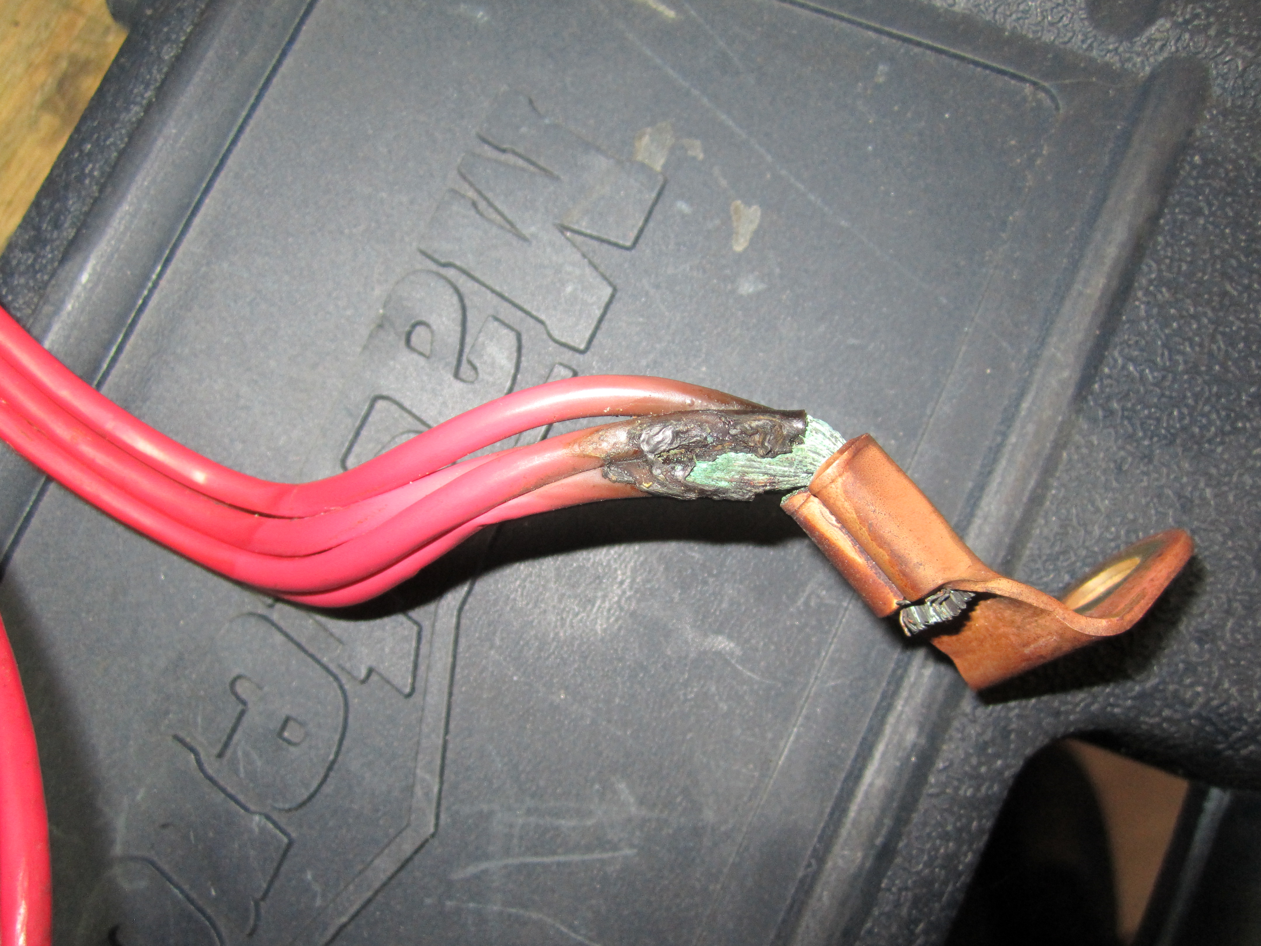

Pauloll: what is the reason for replacing the starter cable and B+ cable?

Give the cables a look. They tend to fall apart at the ends over time, especially the ends at the battery and at the fuse box. You can also check to make sure they don't get warm to the touch. But I wouldn't replace them preventively, just do it if it is needed. Because while it is a good thing to keep an eye on, there is no advantage to doing it now.

Above are the pictures from my 00 V70. This is the end in the fuse box. They last 7-9 years a Volvo mechanic told me. Be careful wht you buy, as even the ones I got from Volvo were rubbish compared to the originals. They look like the generic stuff you buy on line. They came with no heatshrink on the ends and the end of the B+ cable where it joins the +ve cable at the battery in channel sectioned, but the new battery to starter motor cable is flat, so you have to flatten it to fit. The starter to alternator again was a peice of rubbish, and it needed a step made inthe end at the starter motor to fit over the battery to starter cable. Look carefully at the old parts you remove to make sure the new ones have the same profiles. I fitted my own heatshrink and covered the ends with dielectric grease.
I raised the issue with Volvo Canada back in early February through the dealer and am still waiting to hear about why they are selling crap for lots of money (approx $140 CDN each).
Surprisingly, still no answer!
Hope this helps.
